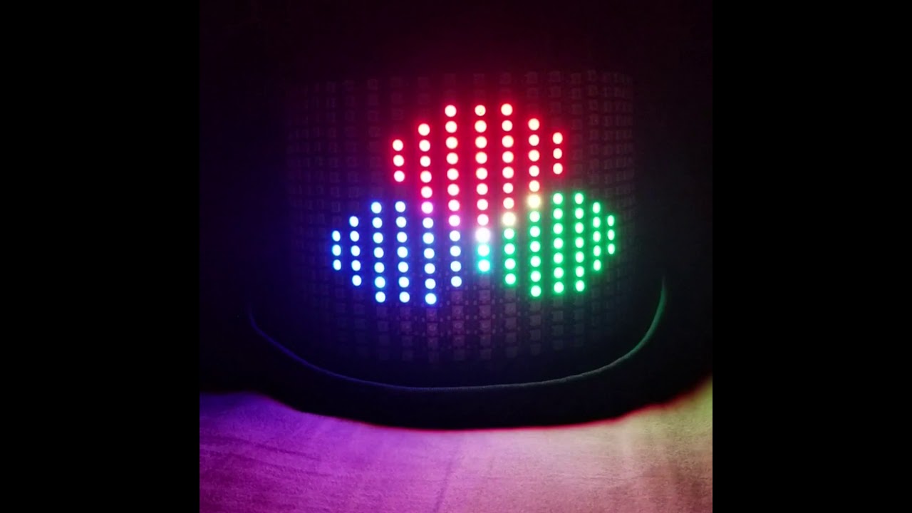

I just posted a video of my top hat which uses sprites to create images. Its super easy to use and super flexible. Here’s the video and here’s the github to the sprites library. Good luck, love to see more of this!
