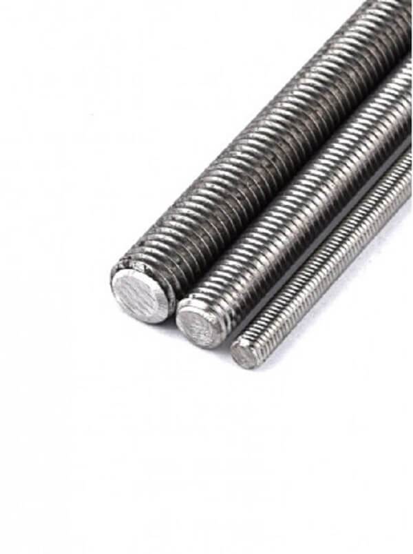

No heat bed, but I thought lead screws and threaded rods were the same thing. I will check into it.
@Clever_Crafts both of these are very different things. check out this link
and post the picture of your rods
@The_Arduino_Guy_Hack Reprap has threaded rods. Are lead screws just better threaded rods?
yes and they improve the print quality drastically as i have both of them i can see the difference.
and also threaded rod have problems like z axis banding and woobling. these can only be eliminated by using lead screw.
@The_Arduino_Guy_Hack Thanks for the link. I understand now. That has been added to my (thankfully) short list.
no problem bro
