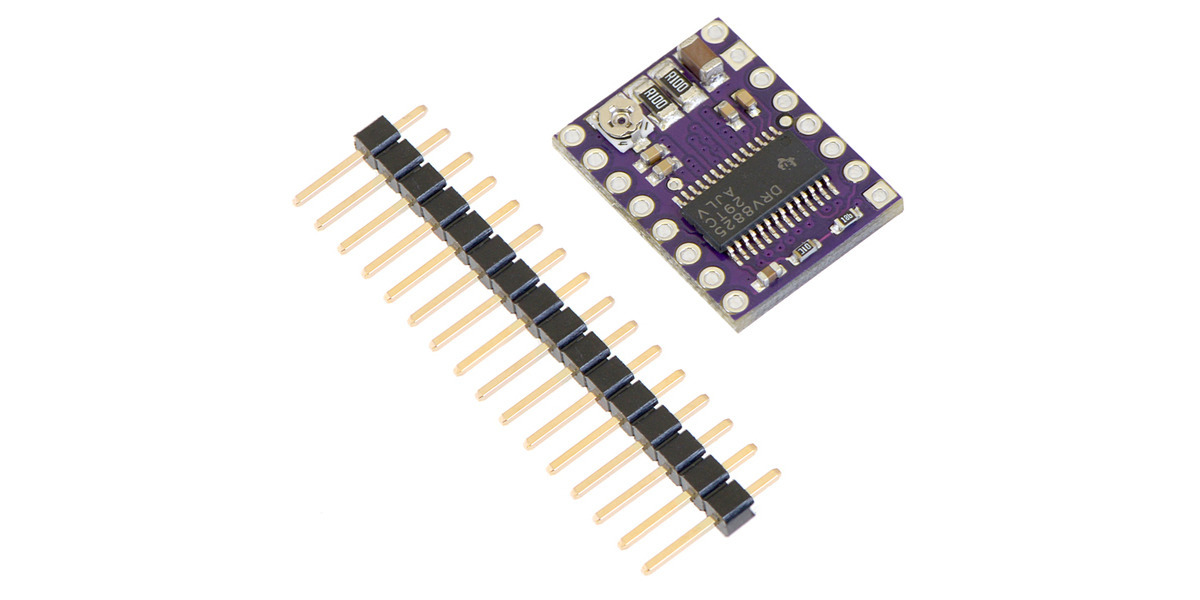

Anyone know why I would get this?
@George_Allen Generally they should all be at the same voltage. Some can be less than max to under drive and reduce heat, if they are low torque.
Carefully read and make sure your stick’s resistors (“current sense”) matches what’s shown here. Very detailed instructions.
Ok, I’m going to try this. All are about 4.7 v
i going to give this a shot here goes nothing
By George, I think he’s got it!
Sweet!
Who says you can’t teach an old dog new tricks!
Thanks a lot guys!!!
