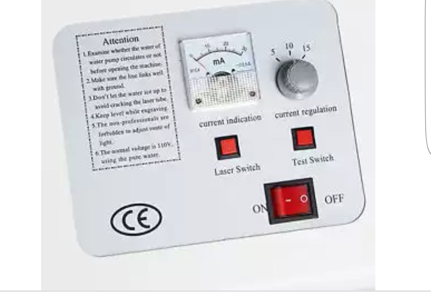

So can i buy the cohesion 3d with the glcd adapter and continue to use the stock display until I can eventually buy the lcd display? Basically, is the glcd adapter pre wired onto the cohesion?
Stock display? Do you mean the digital power readout that some machines come with?
That’s completely separate. You should get the GLCD adapter and get the 12864 GLCD off amazon.
I cant afford the glcd display at this time. Can I buy the cohesion 3d with the glcd adapter and use just the cohesion 3d until I can afford the glcd display?
My machine came with this
