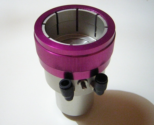

@Brandon_Satterfield Looking at this picture, are we going to have to move the spindle out from the z-axis? It seems this will make the spindle a larger diameter.
@Colin_Kaminski that may well be the case, but hard to tell from the images. An ER-11 can be made to look huge with the right angle. I’ll look tomorrow to see if can get the hall rolling and things like this will be good general questions.

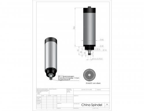

They provided two links stating that the most important dim is 65mm of spindles body and 49mm of the neck.
Here are spindles they state the ATC fits. I have asked for a CAD model.

@Kevin_McNally and all the other guys, was speaking with Joe S this morning and reminded me about this. I received this drawing from the CNC cat guys about fitment. I have not compared our spindles yet .
I’ll check out my spindle here in a few.
Spindle dims differ greatly where I think it matters.
The real meat is going to be how the spindle locks onto the ATC, from forum posts it sounds like the spindle will thread onto the ATC.
