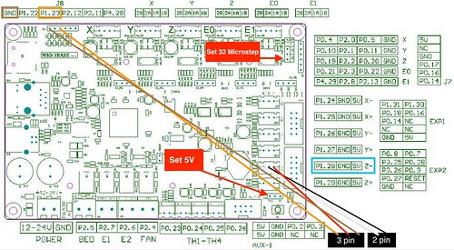

Hi there,
i´m also trying to get my touch sensor working on a mks sbase runnig smoothieware.
My probe is just flashing (error)
My setup is:
Endstop-jumper to 5V
TouchSensor : SBASE
GND : GND Zmin
+5V : +5V Zmin
Zsignal : Zmin Signal
Control : P1.23
My configuration is:
zprobe.enable true # set to true to enable a zprobe
zprobe.probe_pin 1.28 # pin probe is attached to if NC remove the !
zprobe.slow_feedrate 5 # mm/sec probe feed rate
zprobe.fast_feedrate 100 # move feedrate mm/sec
zprobe.probe_height 5 # how much above bed to start probe
switch.servo.enable true # Enable servo module
switch.servo.input_on_command M280 S3.0 # M280 S7.5 would be midway
switch.servo.input_off_command M280 S7.0 # Same as M280 S0 0% duty cycle, effectively off
switch.servo.output_pin 1.23 # Must be a PWM capable pin
switch.servo.output_type hwpwm # H/W pwm output settable with S parameter in the input_on_comand
switch.servo.pwm_period_ms 20 # set period to 20ms (50Hz) default is 50Hz
i do have no resistor between control signal and GND
i tryed do put a resistor between Zmin and GND but this also did not help
Does anyone have an idea what is wrong?
Regards
Stefan
Hi there,
i have found the problem of my non working bl-touch sensor. At the internal control board one of the bridge driver transistors for coil control was not soldered probably. After putting the part back in place my problem was solved.
Sorry i could not post any picture in cause of my user state… up_picr_de/28553876oh_jpg (just replace the underlines to dots)

custom_menu.power_off.command M81 #
custom_menu.BLT_Probe_Out.enable true #
custom_menu.BLT_Probe_Out.name BLT_Probe_Out #
custom_menu.BLT_Probe_Out.command M280 S3 #
custom_menu.BLT_Probe_In.enable true #
custom_menu.BLT_Probe_In.name BLT_Probe_In #
custom_menu.BLT_Probe_In.command M280 S7 #
custom_menu.BLT_Reset_Alarm.enable true #
custom_menu.BLT_Reset_Alarm.name BLT_Reset_Alarm #
custom_menu.BLT_Reset_Alarm.command M280 S10.6 #
## M280 S3 deploy pin
## M280 S5.5 zpin test mode
## M280 S7 Retract pin
## M280 S8.4 self test
## M280 S10.6 Alarm release
