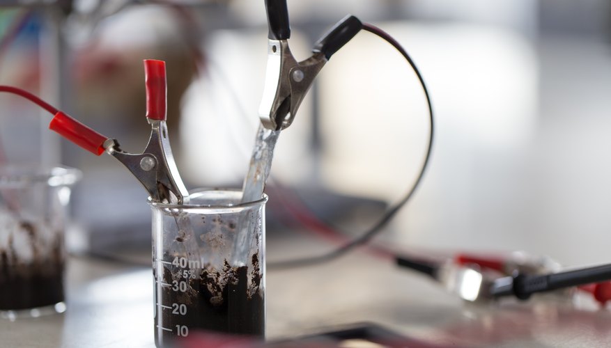

@donkjr There’s a procedure here to measure water conductivity. Could you try it and see if it gives similar results to your meter ?
@artag I have tried it. DC measurement does not result in an accurate measurement because of polarization effects, probe materials etc.
A DC approach may still be useful with some experimentation but since a conductivity meter is so inexpensive I moved on to other pressing investigations. I also wanted measurements that would accurately correlate to published materials.
http://www.analytical-chemistry.uoc.gr/files/items/6/618/agwgimometria_2.pdf
