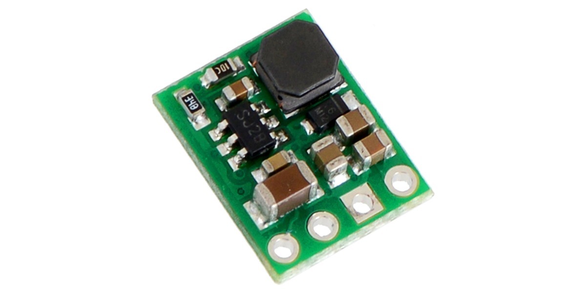

i’ve seen that i need to decrease the voltage of the strip near 3.3v. It’s seem’s to be ok. I’ve order a 3.3v 5v converter to use the full brightness of the strip.
@Jerome_BARBEL you are mixing something up: ESP side = 3.3V, LED side = 5V You should use a 5V power supply and a small 3.3V converter for the ESP
Make sure the converter has a min of 300mA
3.3V 800mA Linear Voltage Regulator - LD1117-3.3 TO-220 : ID 2165 : $1.25 : Adafruit Industries, Unique & fun DIY electronics and kits plus 2x 10µF Caps
