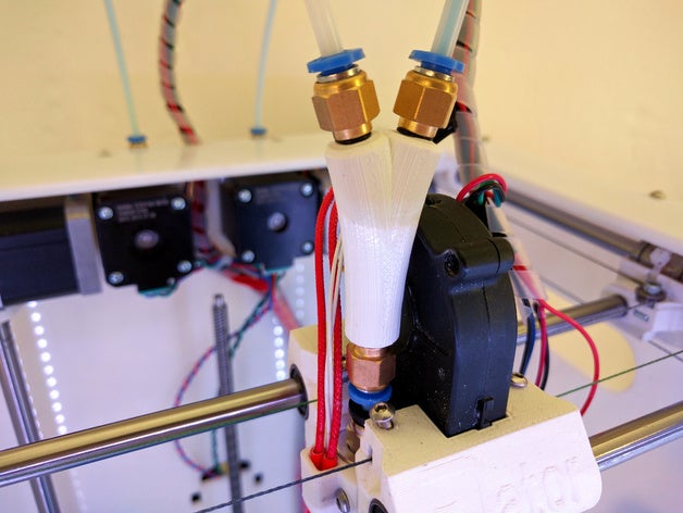

Experimenting with my DIY Y-switch dual extrusion setup.

May i suggest brass inserts for the bowden couplers?
Nice work! Are you posting gcode and files? I wanna play!
@kenneth_rooks good idea - I’ll see if I can source some.
@Ross_Hendrickson My design is based off of what I saw for the Prometheus System, but adapted for PTFE lined hotends like the E3Dv6 Lite.
For an all-metal hotend like the Prometheus, you will probably need a PEEK liner such as their system.
I’ve found a better model on Thingiverse:
yeah, I have an E3Dv6 lite so, I’m of course very interested :). What kind of extruder/hobbed bolt are you using?
@Ross_Hendrickson Geeetech MK8 long reach Bowden
