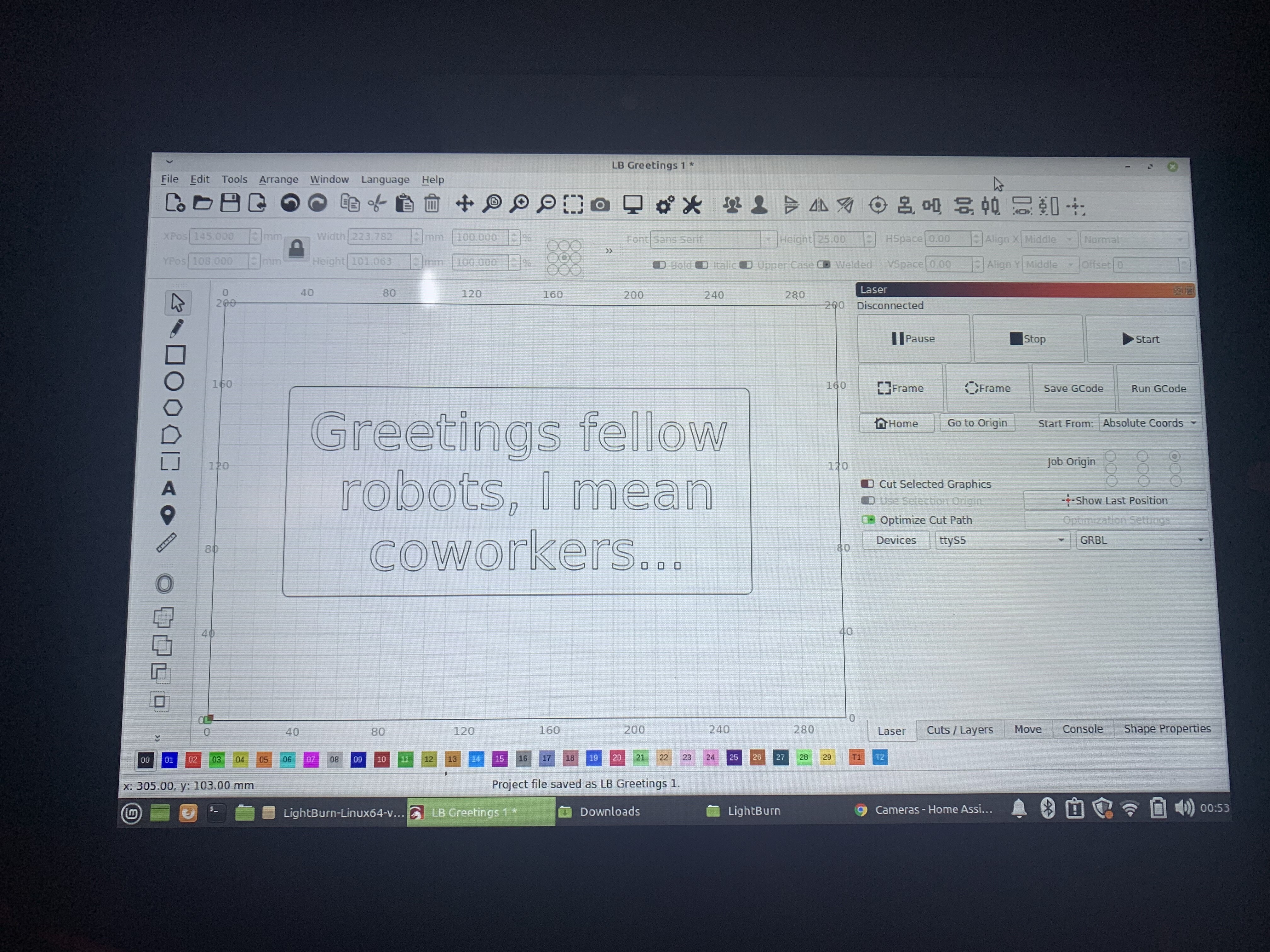

I finally own a benchtop power supply and used it to power up the first tablet. I used hot air and super fine tip soldering iron to remove (read: melt away) the battery connector and solder wires to the terminals.
I’ve installed LB on the stock Linux Mint and used Doug’s guidance to make it all fit.
A few quick questions:
I managed to remove the bottom “taskbar” (I believe this is called a launcher?) how can I get the default one back?
The interface works well with a mouse, but when I touch the screen it is moreso moving the cursor relatively, as opposed to actually putting the cursor at my finger position and clicking (the way a touchscreen would normally work). Did anyone else experience this?
I haven’t gotten as far as PopOS yet. First time bench-powering and soldering at the new place and it took less than a year!
try putting this into a script/file called auto-rotate, make executable and run it in a terminal to see if it solves your cursor problem. As for the launcher, I don’t know how you removed it but I would do the opposite. Myself, I tended to have it hide and auto-show when the cursor is at the screen edge.
But that’s with KDE, not Mint XFCE.
