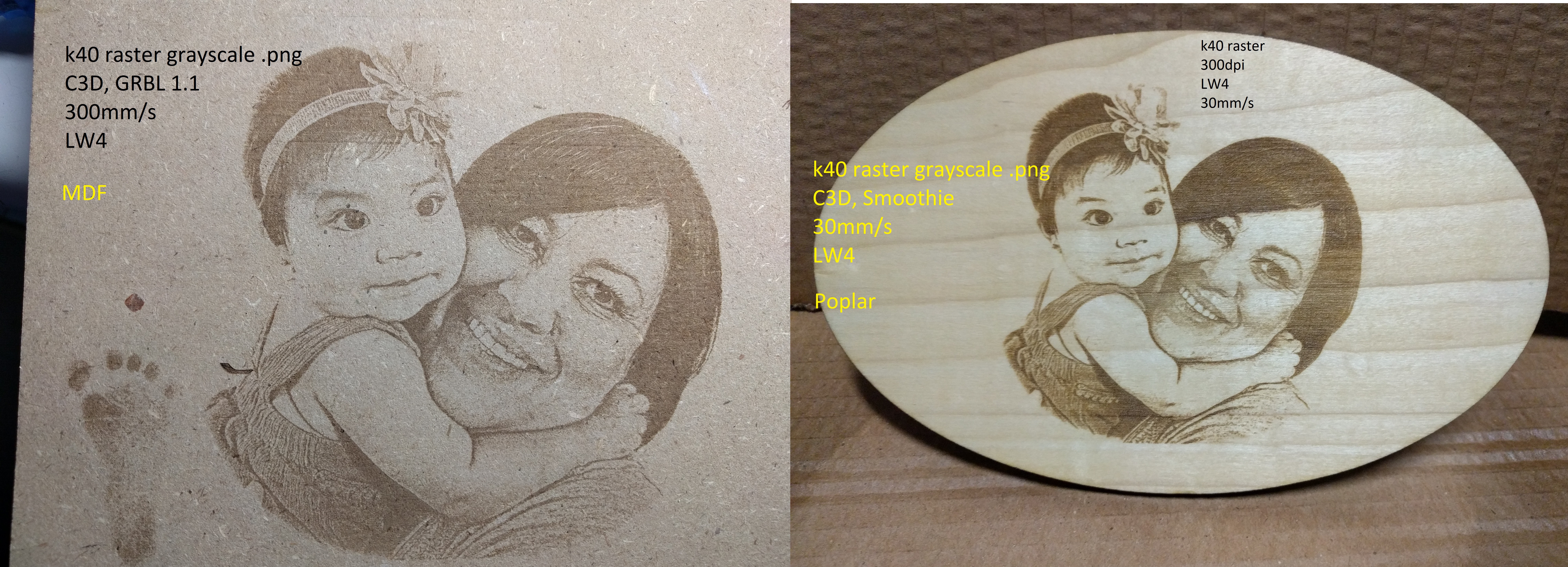

First test with raster image engraving with GRBL on C3D. Image on left is on MDF with latest build of GRBL for C3D (300mm/s NO STUTTERING and 23 minutes to engrave). Image on right is on Poplar wood with same image running Smoothie on C3D (35mm/s STUTTERING and over 1hr 15min to engrave!). VERY happy with this first test! Obviously, it would be beneficial to redo the test with both engravings on the same wood, but thought I’d share some test results from you dev’s awesome work!
+Peter van der Walt​ you are very right!
That looks awesome! And the speed is reasonably fast to. How well is the grey scaling? We could barely get it on Todd’s machine and we are hoping it’s the power supply and not the code.

@Brett_Fleming I will do a grayscale test here in a bit and post results
