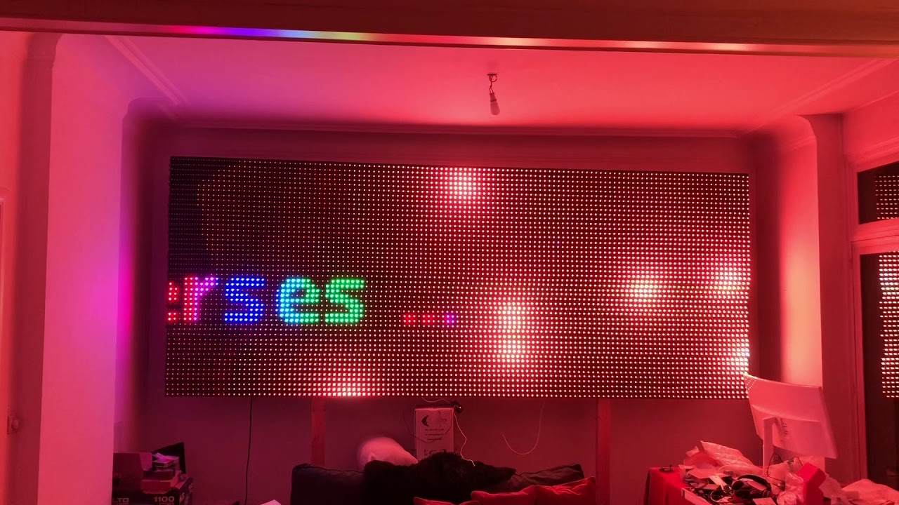

Look at this
I have discovered that the write function is 50% slower when expect on the second core. => I got stucked because I could only record one of two frames … :frowning:
but looking at at the SD implementation that call the SPI library with a slow frequency=> ESP32 can go high frequency so I changed that and that did the trick.
Plus one mistake that causes the half frame issue.
Still artifact can stay but I think now it’s looks pretty good
I am using 35 universes on my panel, I Hope on yours it will be perfect.

@Yves_BAZIN whoo… you are cracy did you write on this the whole night? :smiley:
I did not even have breakfast and tried it … but i already have more jerks in the animation than i see in your video… but i think they are little bit less than before…
could it be that this is because of my slower sd-card than yours. is it possible to lower it more for my sd-card?
if(!SD.begin(5,SPI,20000000) //the 20000000 is this the frequency rate?
with my little understanding in this it will maybe function when lower this …one moment
no there is nothing different if i do this e.g. 10000000

yes i did this … i can show you a video of it.
if(!SD.begin(5,SPI,80000000)){
@Stef_Weicks you need to do it in both programs (sorry if you did it and I did not understand)
oh yes i see … i only did in the write to card program… i try it
the animations are faster … but no improvements… here the video
i reduced the frames in jinx from 25 to 20 fps. there is already the same issue
