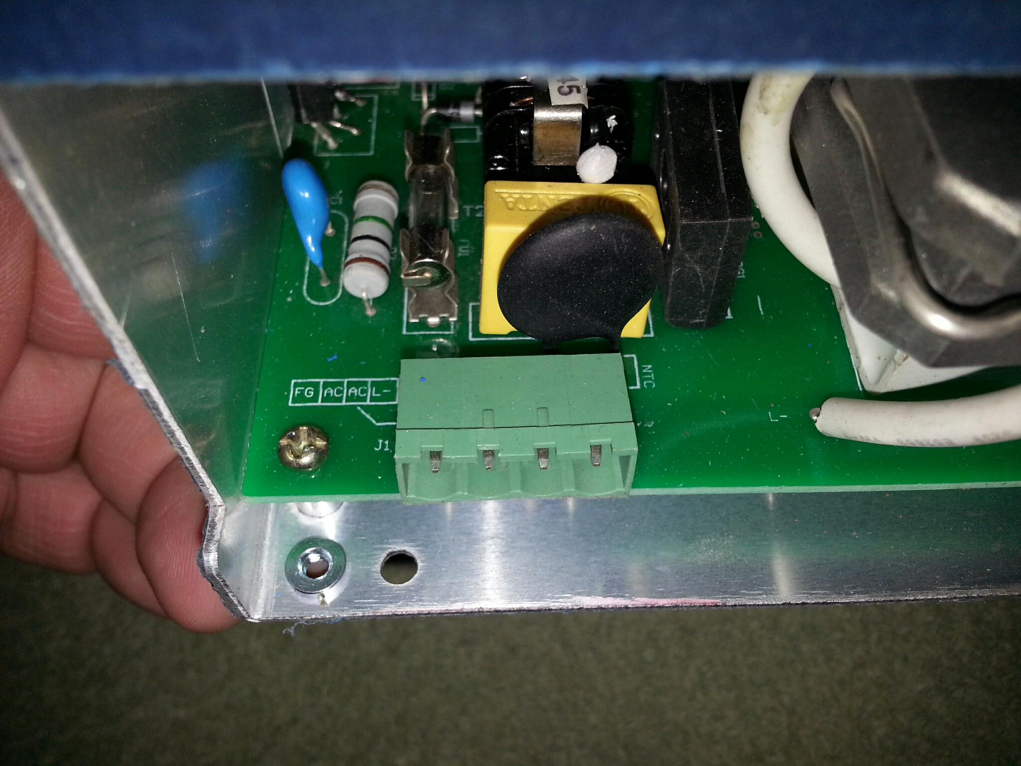

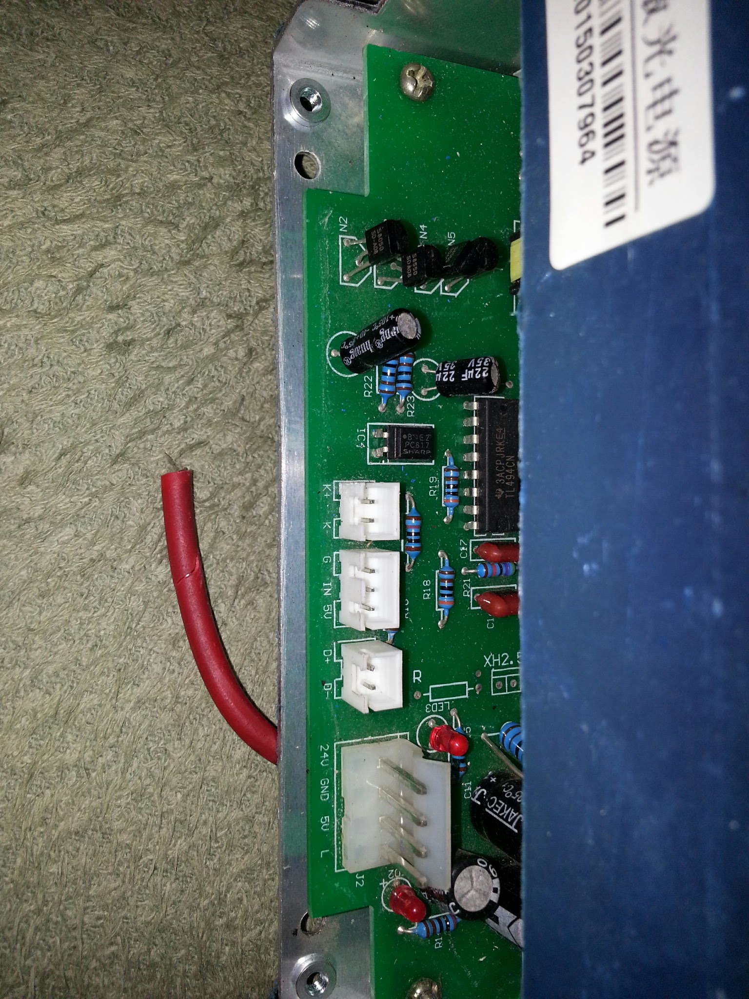

Any info on this type of supply? I tried your site Don but didn’t match up.
Looks like mine with the JST connectors - I recognize those. Not sure where the green pluggable terminal (2nd pic) is in relation to the first pic.
in on the opposite side of the psu same side as the “clear” 4 pin
What i mean is on the back but same side of the board right/left
I’m redoing the wiring and the psu wasn’t plugged in so kinda lost here. What would k+/- and d+/- mean
@Chris_Menchions I’m guessing using the same naming.
On my supply K-, K+ is the “Laser Test”
that would logically leave the D-, D+ to be the “Laser Switch” function (interlocks and panel switch).
What is the 3 pin for? gnd,in,5v
Potentiometer. IN is the wiper. That’s where our pwm signal feeds into.
@raykholo I would not use IN I would use “L” :).
Ok L is on the bigger 4 pin
Put pot (5K) across 5v and gnd with the center wiper on IN.
On the connector with the 24VDC.
