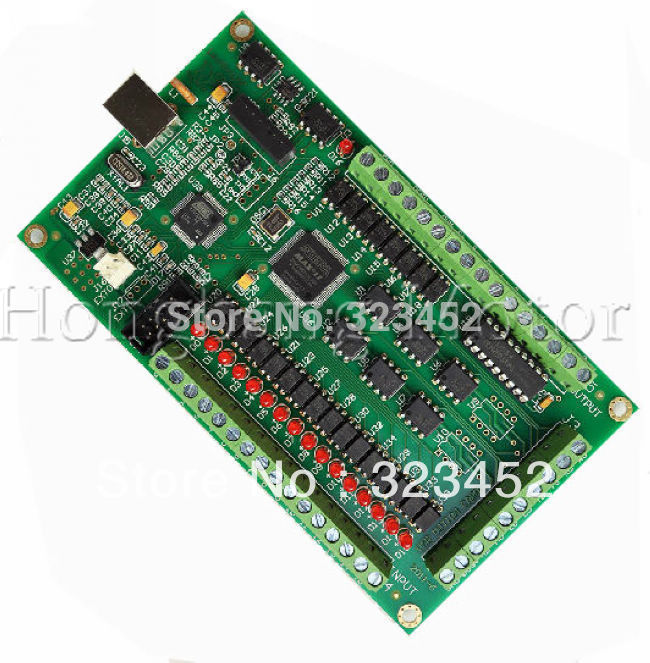

@Paul_Frederick @Marcus_Wolschon is this a good board this is a USB based board

@Bijil_Baji I use that board in my small CNC but I payed much less for it.
I don’t know if it’s possible to use it with EMC2.
@Marcus_Wolschon
LinuxCNC formerly known as EMC2 does not support real time USB output. The USB protocol itself does not support real time either for that matter.
@Paul_Frederick what are you talking about?
This board DOESN’T NEED anything to be real time. That’t the whole point of it.
It’s not a breakout board. It gets commands and does all the realtime stepper pulse generation in itself.
Also YES, USB does support isochronous data transfer.

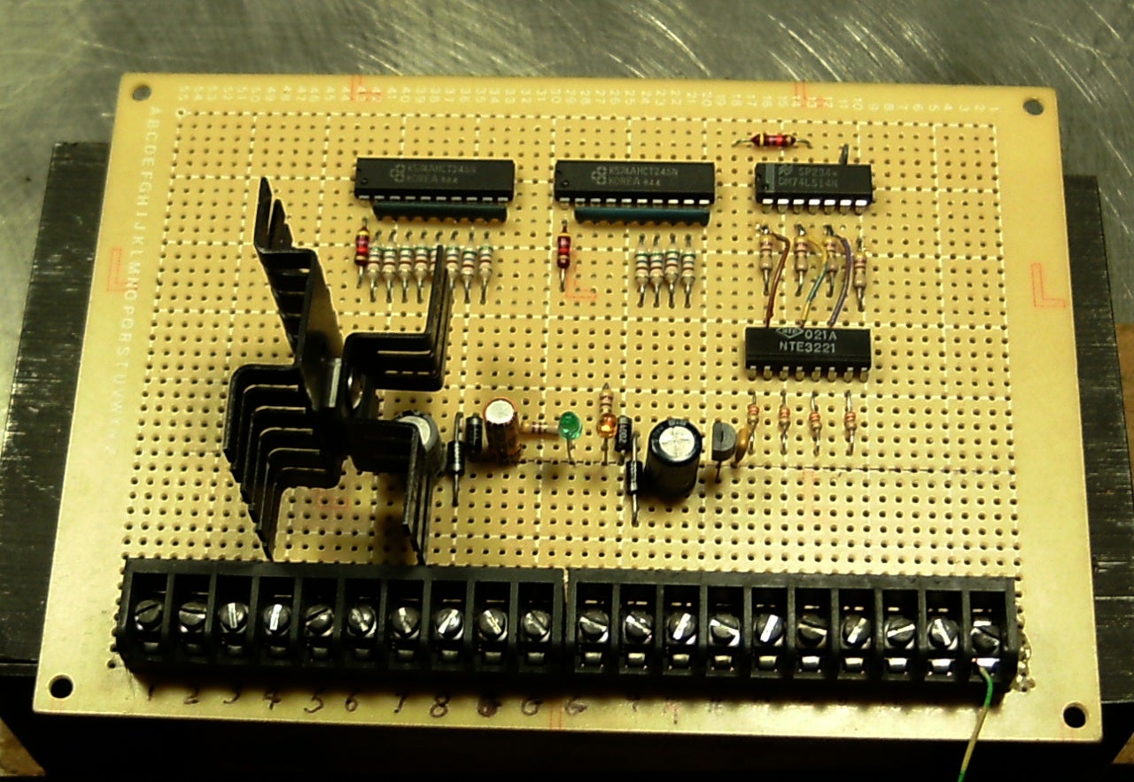

I made my own break out board. Plans are here:
