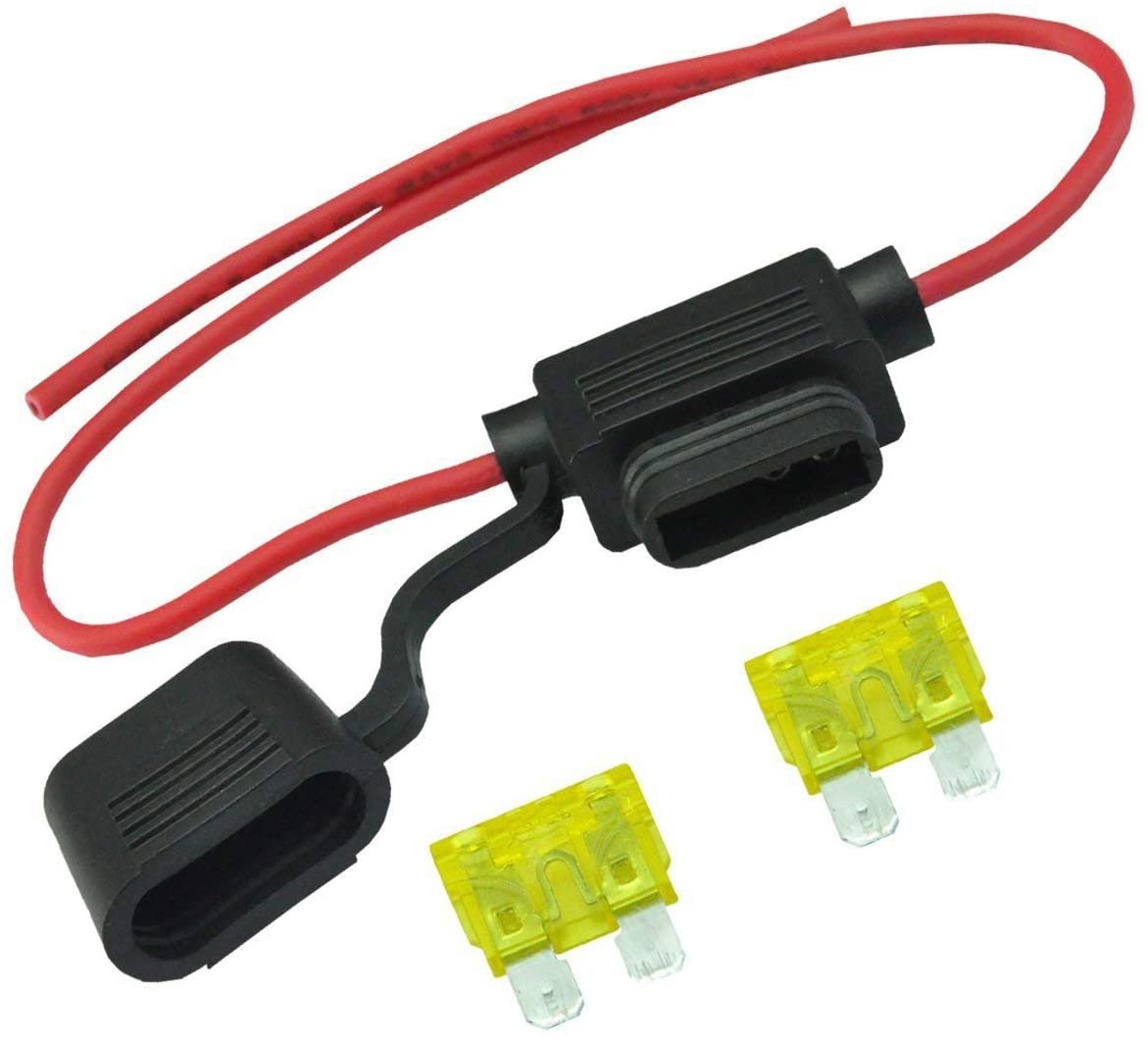

Oh and put a fuse in there on the imput from the power supply, this way nothing catches fire. Something like this https://www.amazon.com/gp/aw/d/B013JG8GIY/ref=mp_s_a_1_6?ie=UTF8&qid=1493404555&sr=8-6&pi=AC_SX236_SY340_QL65&keywords=inline+fuse&dpPl=1&dpID=41fGUJlSOrL&ref=plSrch
You can get the fuses and fuse holder at an automotive supply store locally, if you have one!
