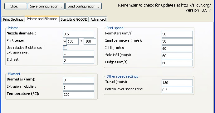

There are two big things I suggest people do. Level your bed and use two temperatures, one for the initial layer and then drop it down. I start at 110 and drop down to 90.
@Richard_Horne has an excellent (although slightly dated in terms of what the software can do now) guide on how to get excellent prints. The link has a section on getting the first layer to stick well (which will help with warping).
