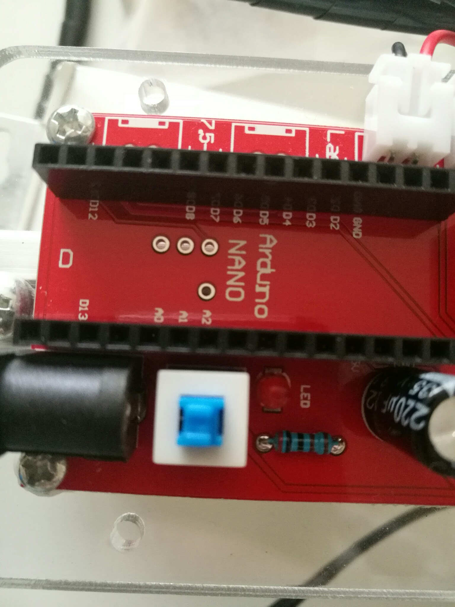

So I don’t have that jumper as it’s a Chinese clone hmmm just watched a video on YouTube where you have to change that jumper bugger what next :see_no_evil:
Bugger how do I tell if it’s a PWM laser dude?

Please post a picture of your board, especially the part bellow the Arduino Nano.
