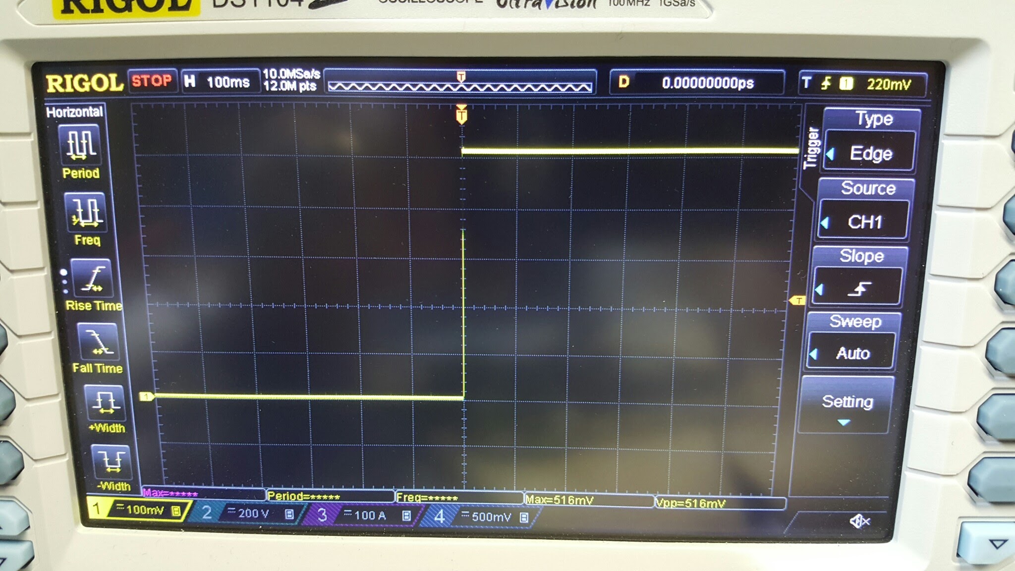

Ok, here are some scope images. Remember that I’m not exactly an expert with these things but… images at 1%, 50% and 100% power. Looks like a good signal from pin 2.4. I’ll post my config file next.

@Chuck_Comito these scope signal look good to me.

Are the scope traces before or after the pot change?
