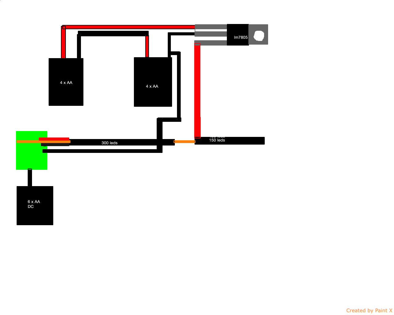

I did some research on regulation and I tried to draw a wiring diagram using an LM7805 but as I’m aware it looks like they are made for use on a breadboard which I am not currently using so I am not sure if wires wrapped around / soldered will work the same. It seems they need minimum 7v input and I have 2 4xAA battery holders i’d like to wire in series (if possible to save on costs since I have spare ones) and I could just use 6 batteries instead of 8 so there isn’t a lot wasted energy or more heat being dissipated.
I will be resoldering the connections later today to rule out a cold solder or bad connection. Please correct me if i’m wrong on anything, thanks again!

Yeah, soldering them to wires works fine. Just need to make that connection, and cover the exposed leads, of course.
Not sure your battery holders, all I’ve ever used need to be filled all the way to make a circuit. But no harm trying it out and seeing what the multimeter says.
Just connect the gnd going from the battery pack to the lm7805 to the 150 strip. You can even just make a loop: battery>lm7805>strip gnd>arduino gnd (or even the gnd pad at the end of your 300 strip)
