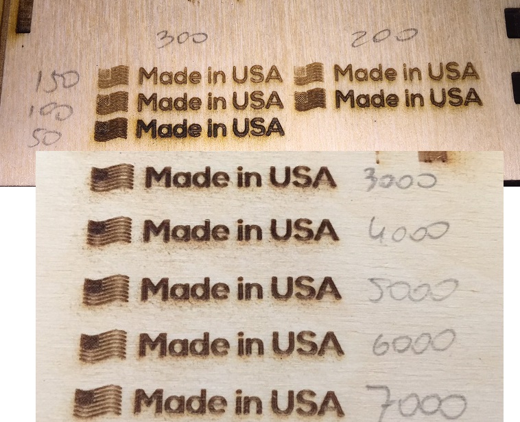

I played with PWM from 7000 down to 1000. I noticed that once I reach 1000 I can’t go back to lets say 5000 without a power cycle (K40). It just wont fire.
Tests with grbl-lpc (changing pwm)
line distance: 0.05
power: 5
speed: 100
Smoothie back and a few tests:
line distance: 0.05
power:5
speed from 50 to 150
pwm period 200 and 300
I know thats not a good comparison between the two but I have to say (with great sorrow cos I’m a grbl fan) that smoothie is giving me better results for now.
