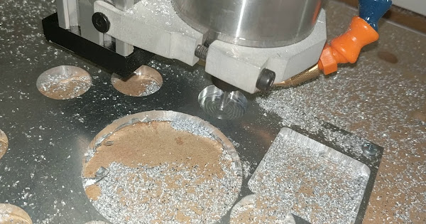

This time I was at 0.5doc, 500mm feed, 19646rpm. This gives 0.001" chipload. Looks better but still that nasty chatter on the last pass and I am once again out of round.
From watching this one it sounded like there’s a little chatter on the stepover maybe so I am doing it again same settings but slower stepover feed rate.
So…reducing stepover feedrate helped a little, this started me thinking down a whole other path. What if its not just deflection on the bit, but what if the movement towards the wall is causing ringing when it stops?
My jerk settings on my TinyG G2 firmware were at 5000M mm/min^3 which is what they recommend for Shapeoko, and I’ve been using these settings for ages (as has @Brandon_Satterfield ) But at this point I thought I’d try anything.
Reducing jerk to 1000M mm/min^3 helped a bit, and finally reducing it down to 500M mm/min^3 has resulted in something passable I suppose.

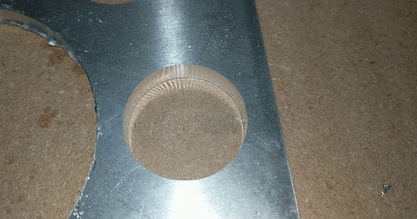

More chatter on that final pass than I’d like, but its not throwing the entire hole massively out of round anymore, there’s a very slight deviation where the chatter is but its in the <0.5mm range now. And checkout the surface quality of the finished cut:
So, is it possible this is all just tool deflection? And the reduced jerk has hidden what is actually a badly deflecting system? Or is it actually ringing on that last move out to the wall?
In the end I asked the machine for a 28.45mm hole, and I got a 28mm hole dead on as far as I can tell, maybe a hair over. The 28mm bearing the hole is intended for fits perfectly with no interference and no detectable movement with the limited sensing abilities of my finger.
