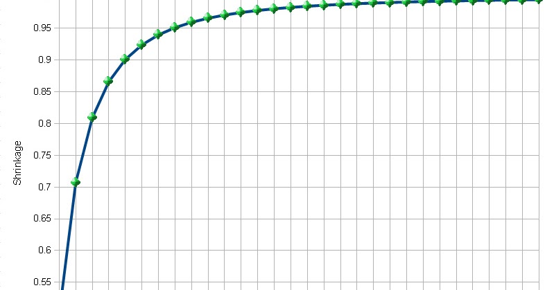

I use nopheads math, and added a few other things to account for n-sided holes (a 4 sided hole has a larger diameter than a 6 sided). You also need to account for extra material in the corners, like for nut capturing I cutout a bit at each vertex, the plastic extrusion can’t make perfect bends.
External accuracy is a function of the slicing software and layer height. I believe nophead did the math for that too.

I typically adjust my models (e.g. slightly larger holes) instead of scaling. But I agree with @Eclsnowman 's solution: calibrate as close as possible and then scale according to the plastic being used. Also, @Stephanie_A makes a good point about Nophead’s math. If you haven’t read his Polyholes post, I highly recommend it, as well as pretty much all of his 3D printing posts, which are always densely packed with well thought out information/tips. His blog (like RichRap’s) is required reading for the serious 3D printing junkie, IMHO:
