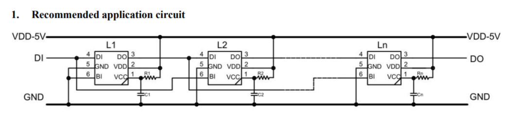

I have troubles understanding the consumption of a single ws2813 5m stripe.

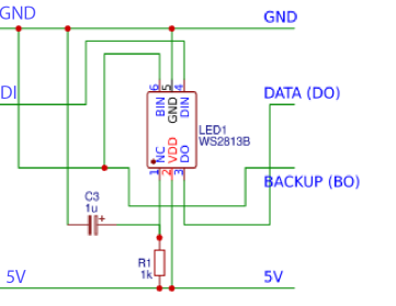

ok, so, you gave me the click to try to make a PCB out of a part of the project. in particular the part that I attached below.
Note: this is considering that everything is ok, so it is subject to changes based on your future feedback, but im trying to get my hands out of the tools :slight_smile:
I have no idea about the value of the capacitor C3 or the resistor R1
Also, I connected BI (BIN) to BO, not sure if it should be like that…
So you will see attached the part that I am trying to convert into a PCB. I think it can be interesting to learn that + it can be useful for any other project, indeed, by simply using this PCB, a LED strip will be ready to use more easily. However, I think I am facing an issue due to trace width…

C: 6,3V is ok for the bypass capacitors since they only have to stand the 5V supply voltage. Lower rated supply voltage results in smaller packages at a given capacity. The related ā€œbest adviceā€ often read says to put some 1000uF in parallel to a strip’s power pins. Use 330uF or 470uF at each strip I would say. It can often be read this is to compensate varying supply voltage like over shooting, but I think a good power supply serves better here. Another issue here are voltage spikes generated by the inductance over the supply lines as reaction to the pulsed current drawn by the led’s pwm circuit. To counter that problem bypass capacitors are already placed near every led on the strip usually. But adding additional capacitance near the strip is never a wrong idea though. Low impedance is adviced for bypass caps wich means tantalum or low esr electrolyte types, alternatively connect 100nf ceramic in parallel.
R: The thermal dissipation limit (the wattage) of the resistors should be irrelevant as they are placed in the data lines.
MAX485: These are differential line transceivers. One needs to be placed at each end of the line. This seems unpleasantly complicated on one hand but gives you several hundred meters of range on the other. There are cheap modules on the market at least. Google for examples and read the datasheet :).

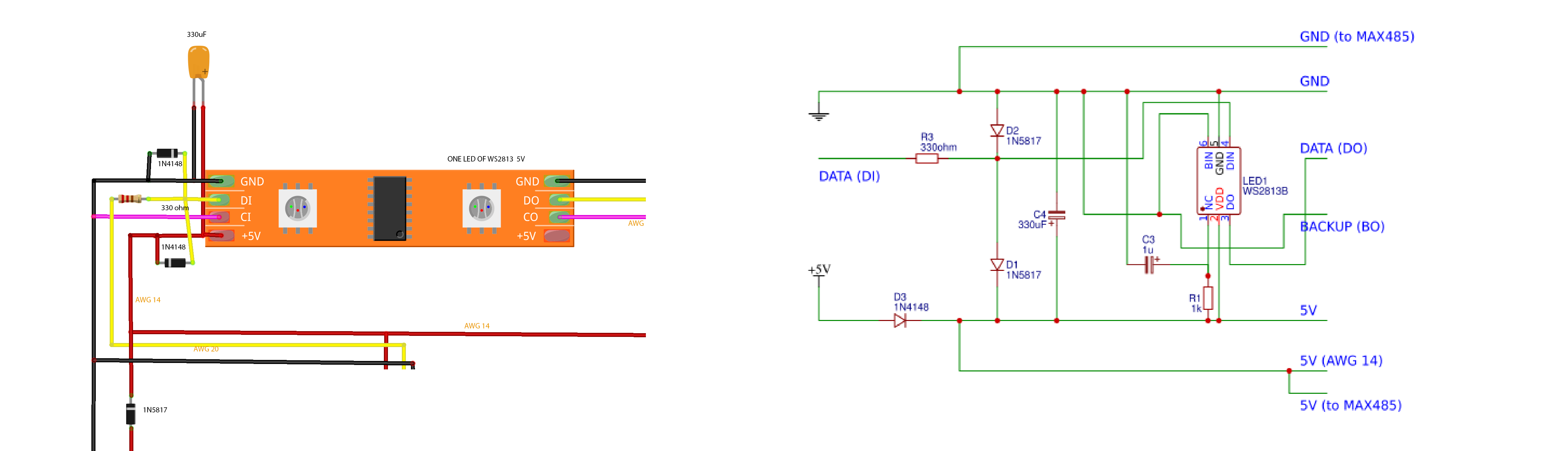

@Michel_G_Khoury Hi, i have pushed a reworked schematic to the repo. I have used your sketch of the board with the strips applied to place the MAX485 modules at proper positions. Anyways, I would test if they are necessary at all, maybe transmission will work for a distance of 1m or more…
Whoa, fritzing is looking nice, but it is a buggy mess -.- If you really want to make some PCB have a look on KiCAD: http://http://kicad-pcb.org/
Answers to bonus questions:
1&2: No, the 1N4148 has the sole purpose to lower the supply voltage of the first LED by its forward voltage of 0,7V to approx. 4,3V. It therefore only needs to pass 60 mA.
3: Yes and no, on each branch there will be maximum of 18A / 5 = approx 3,6A. Supply load will nevertheless 18A max, the sum of the branches.

7- yep, will check out KiCAD for that. What I meant by the attached area is basically in picture attached of previous post. It is: the first led (not stripe) + capa + resistor + 2xschottky (and maybe + 74HCT245 then, instead of the 1N4148).
As the PCB will need a real LED, not a cut from a led stripe, i will need to follow some wiring as per image attached to this post, but I still dont know the C3 and R1 value.

7: Hmmm, if you use a dedicated level shifter, there would not be a separate first LED? Resistor 330 ohms, the protection schottkys and the bypass cap should be placed as near as possible to the first LED of each strip. You can solder them directly to the strip or make a small PCB for that. It is still not necessary to route the 3,6A (only the main supply line before any branches is loaded with 18A) over any PCB, but nevertheless would not be harmful on such short distances. The controller and the level shifter could be placed on another PCB. R1 and C1 shown in the above schematic are not making much sense for me, as the pin they are connected to is designated ā€œNCā€ which means ā€œnot connectedā€ ^^ Each LED on a ā€œnot too cheapā€ strip has his own bypass cap anyways. I guess you can ignore these two components.

7: Bypass caps at every supply point. 330 ohms resistor at every end of a data line, that is not realized with MAX485. Protecting schottkys at the first strip and optionally at every other 330 ohms resistor.

4- Regarding your answer : ā€œR1 and C1 shown in the above schematic are not making much sense for me, as the pin they are connected to is designated ā€œNCā€ which means ā€œnot connectedā€ ^^ Each LED on a ā€œnot too cheapā€ strip has his own bypass cap anyways. I guess you can ignore these two components.ā€, please see image attached, this is where i found out about the capa and resistor

4: OK, R and C work as filter element here. It’s a kind of bypass capacitor with improved properties targeting the reduction of electromagnetic interference (EMI) caused by the fast switching of current by the PWM of the LEDs. In case of asking yourself how this can happen: The hard transients when switching from 0 to 60 mA in nanoseconds (switching lights on and off) is containing signal energy in the rf range. Under circumstances some meter of strip and supply lines can work as antenna for this to be radiated of :slight_smile: But after all, these components are included in the ready bought strip, no need to worry about them.
