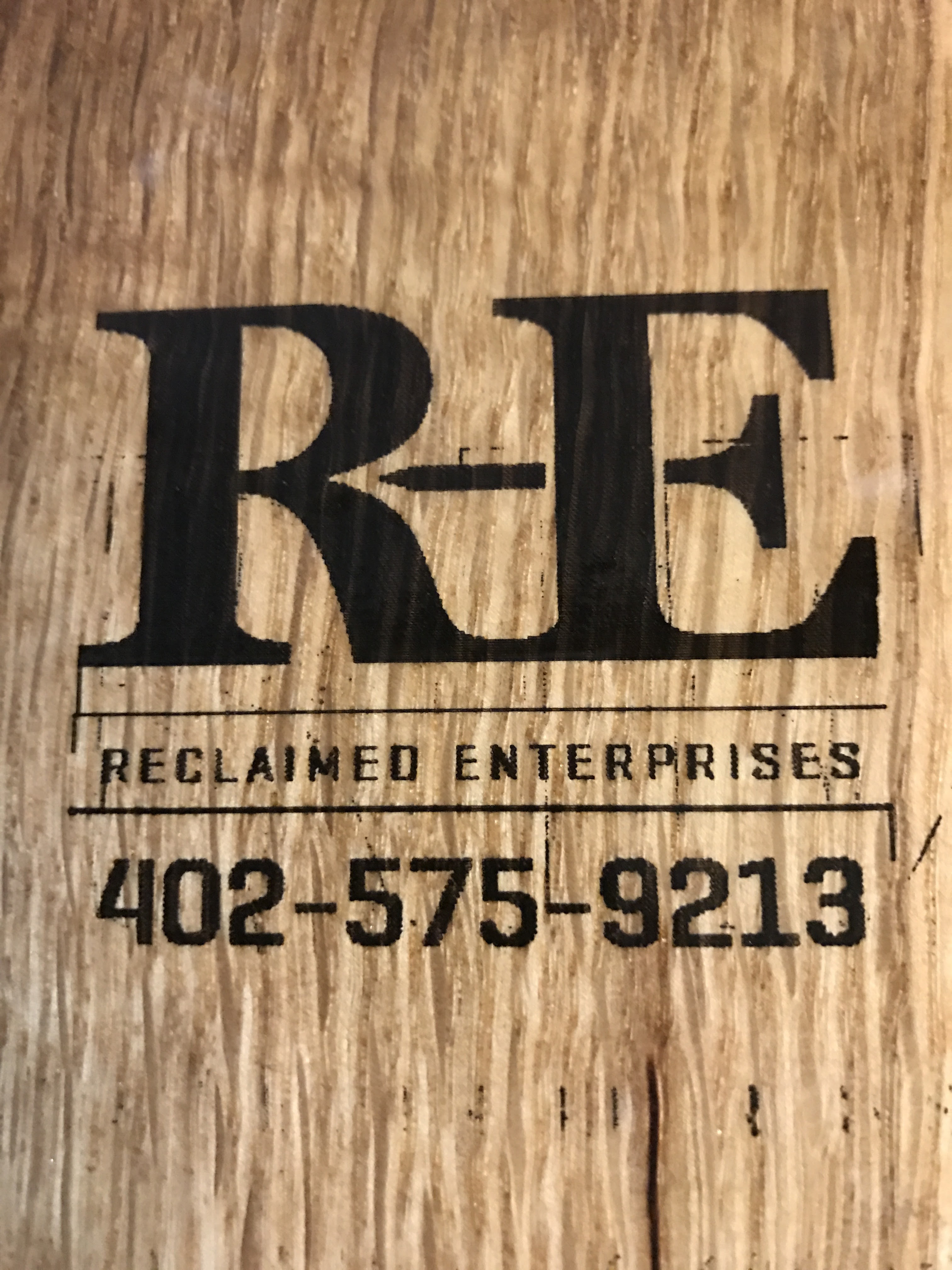

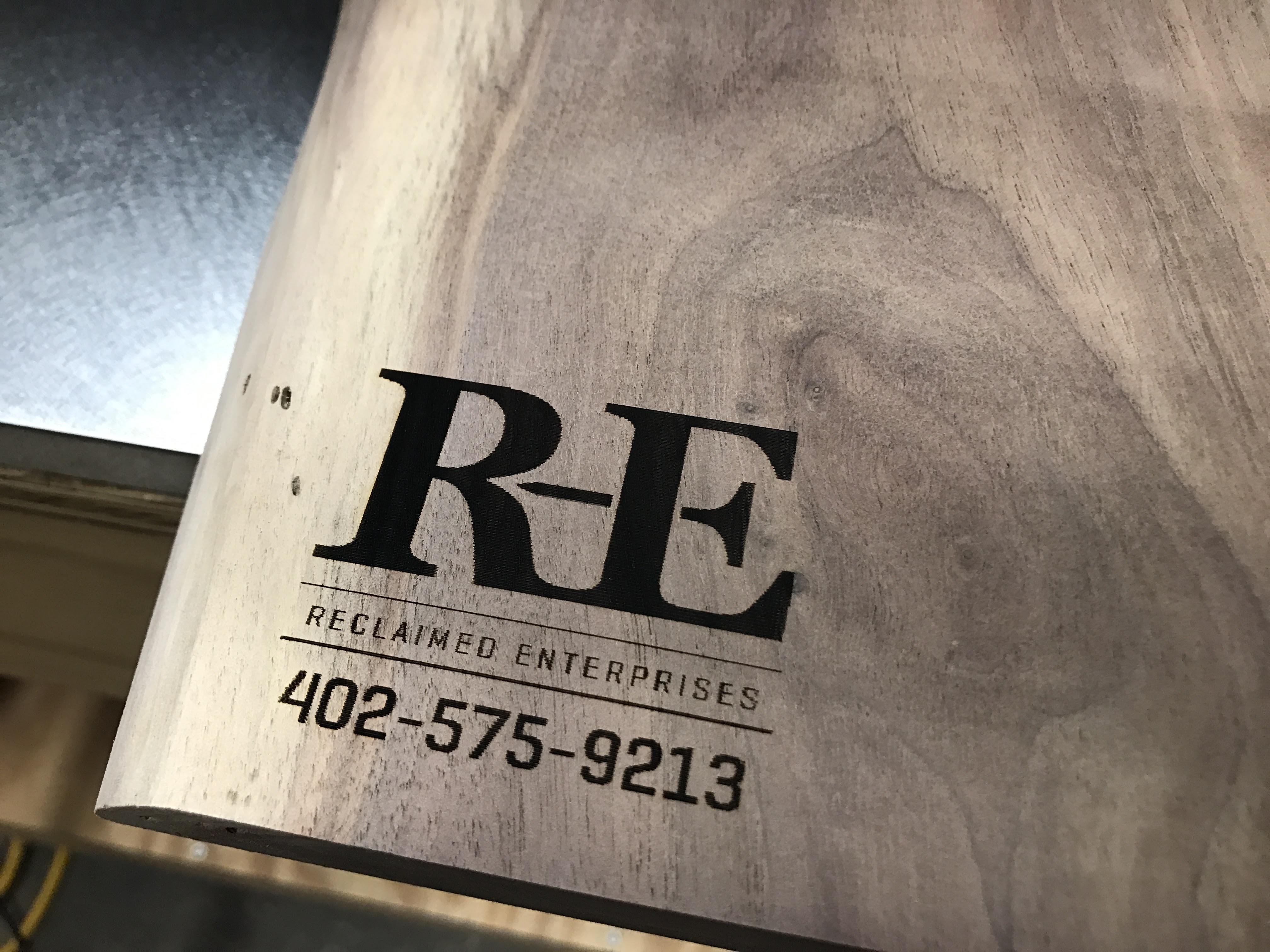

@cprezzi @Ariel_Yahni_UniKpty Ok things are going much better today, it was the 160 numbers on the size. things are sizing up great now. I flashed the board to 1.1 and I got the laser to turn on however I seem to be getting these pigtails a the end of vertical moves you can see them in the picture. any idea how to stop that from happening?
