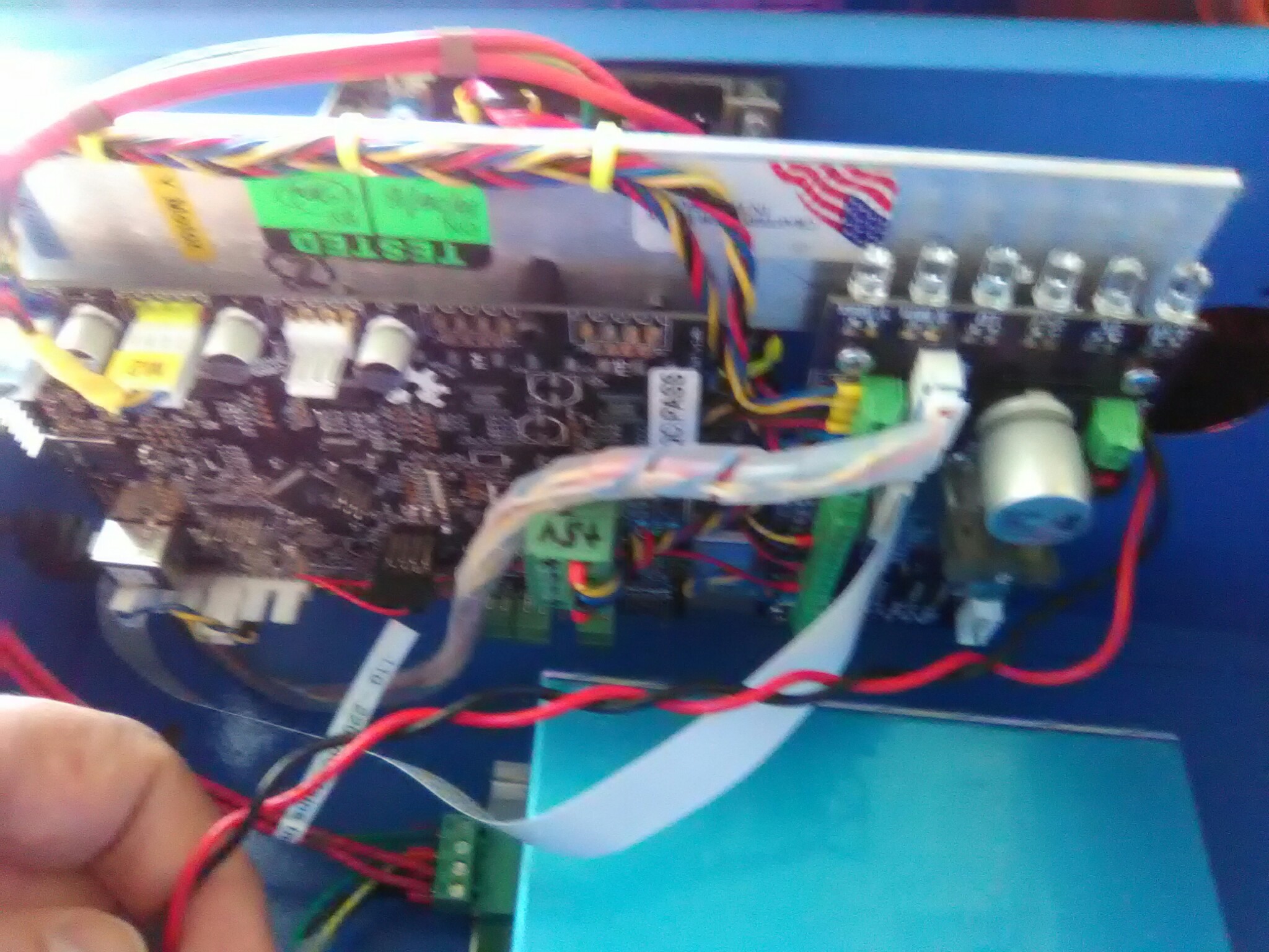

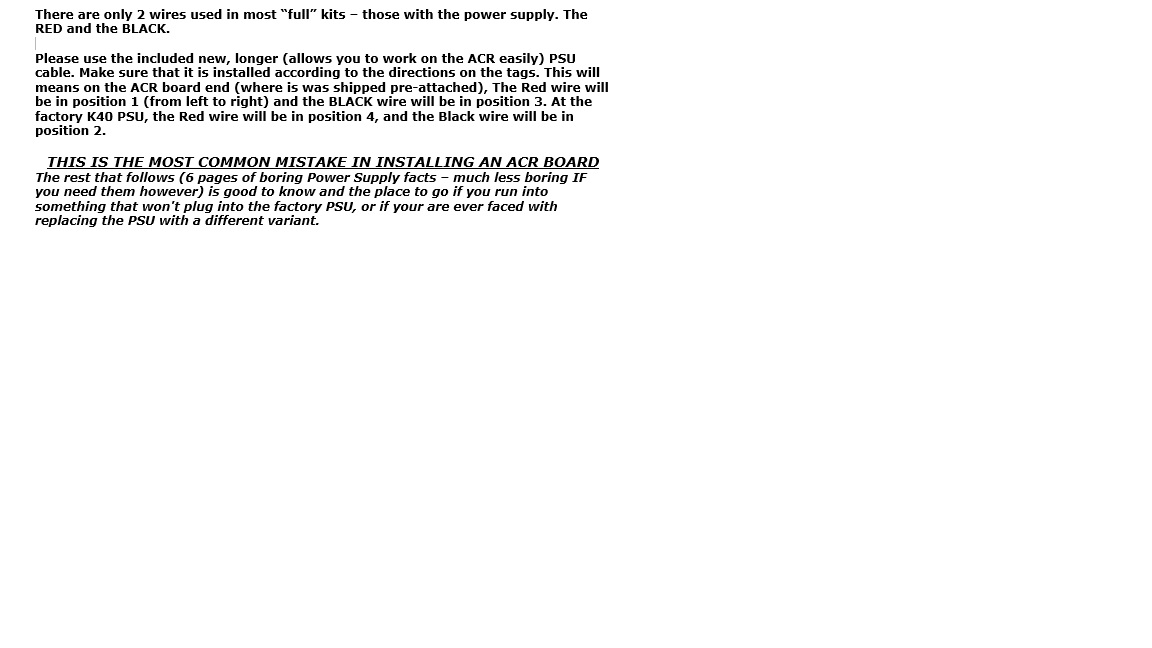

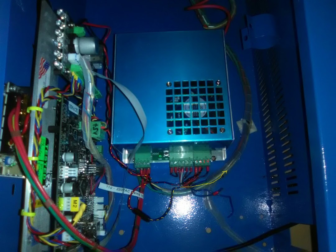

There was probably a wiring mistake made for sure. Keep in mind Scott had not worked with this power supply before. He was also telling me what wire to put where over the phone and could not see what was happening. A lot of room for error for sure. Here is a screenshot from Scotts ACR manual as well as a picture of how my ACR is wired right now. Can someone look at this and verify that the black wire from the ACR should go into position 2 on the PSU?

that would connect the ACR output to 5VDC so I would not do that!
The LPS DC connector is as such:
Starting from the right going left:
L
5VDC
Gnd
24VDC
I don’t know what the black wire from the ACR is?
OK thanks Don. I won’t do that…
I just saw the instructions that you posted. The pin descriptions are from left to right and suggests:
Black to pin 2 that is grnd
Red to pin 4 that is “L”
So if you are wired like this you are correct.

@donkjr take a look at this picture please. The black wire from the ACR is going to pin 2 which is what you were thinking should be right but… the red cable is spliced to another cable going up into the K40 cable wrap and not into pin 4… This could be the mistake right?

I cant see any of the connections on the ACR.
Can we used the name of the connections on the ACR as well as the wire colors to identify stuff.
Perhaps multiple pictures taken perpendicular to the controller.
@donkjr the other end of the red and black wire are already connected to the acr. Scott shipped the acr with the black and red wires connected on the acr
@donkjr I will send a picture of what I mean she. I get home…
