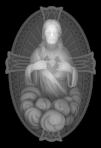

For those who are curious this is the type of image @Scott_Thorne ​ is working with
Besides looking for just 3d grayscale you can also search for depth map when looking for images to test on
