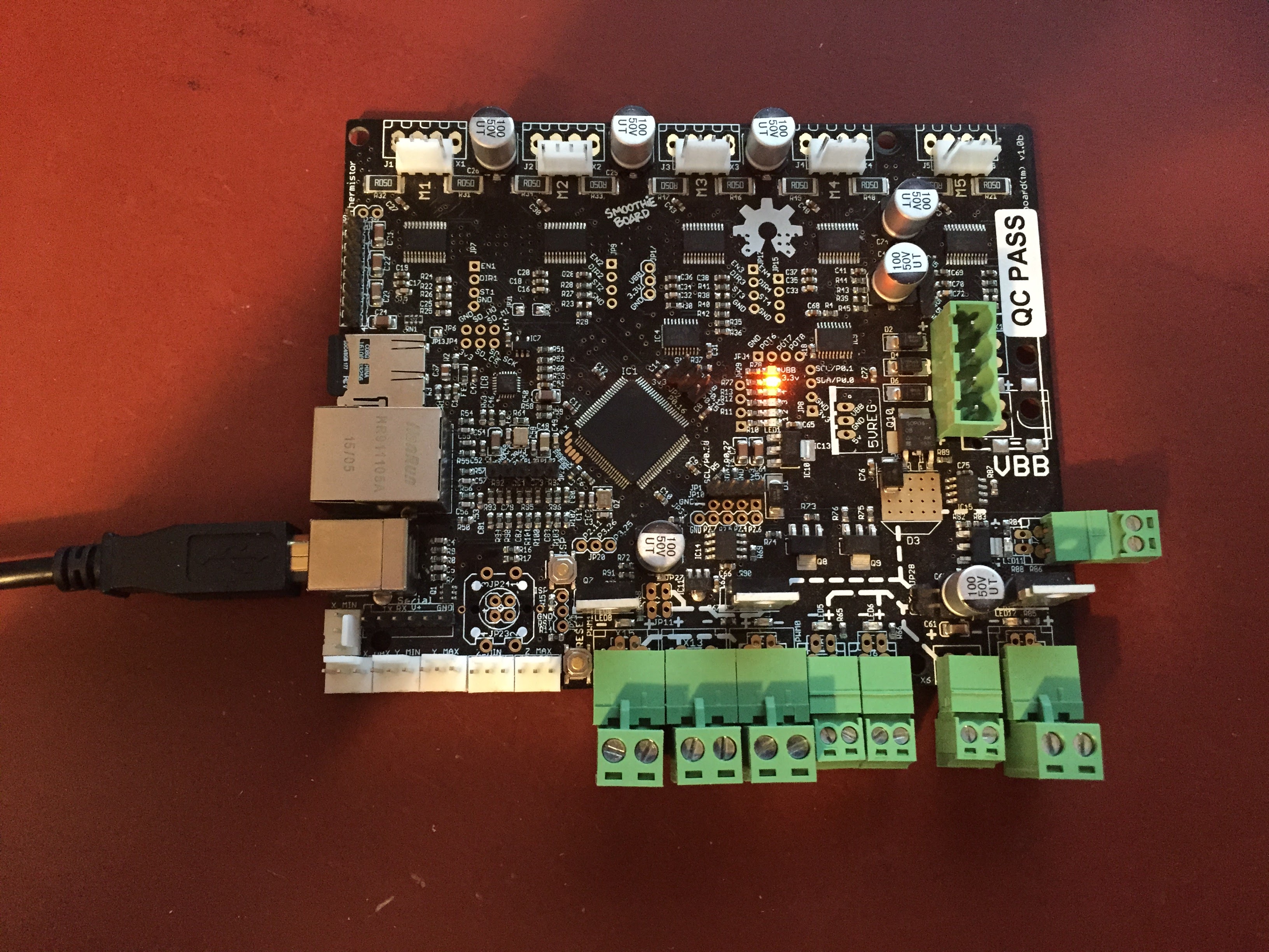

I have my genuine Smoothieboard 5x here. I have gone ahead and flashed it with the latest edge from 3 days ago, and loaded up a brand new clean config file from the Smoothieware Github. Plug into USB, LEDs blink, Windows recognizes it, all is good.
Now let me go ahead and define a 3rd extruder module using some spare pins (2.11, 3.25, and 3.26). LEDs are still enabled in config, and we’re using non status LED pins here. Save, safely eject, and reset the board. Boom, board will not boot: 3.3v LED is on but L1 - L4 are off and Windows says device not recognized.

The same issue occurs on all firmware edge builds I have tried going back to August 2016. Is there anything else you would like me to do to demonstrate the issue or to help debug?

Board does not boot, usb device not recognized, all same as before.
