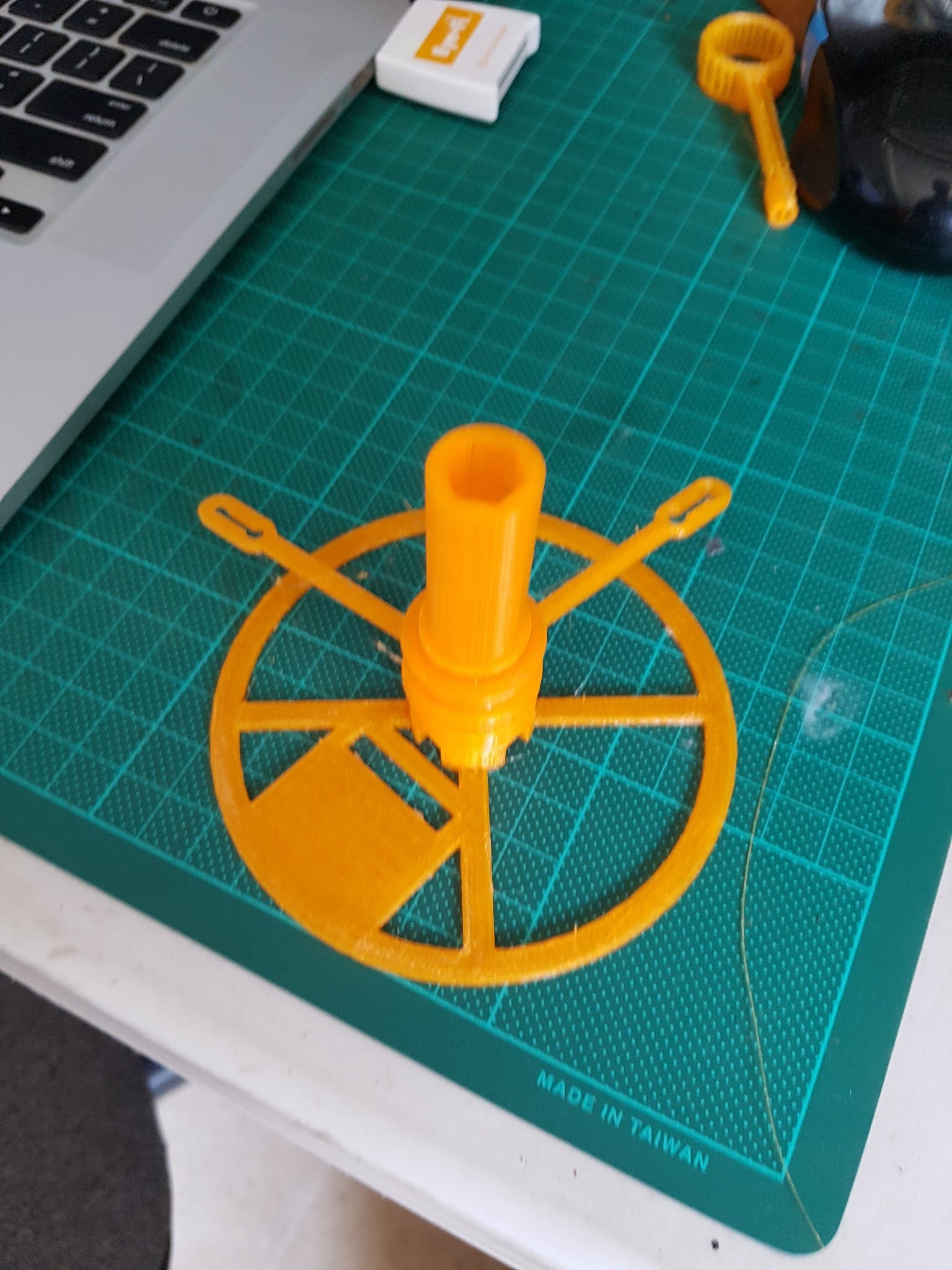

@Ariel_Yahni_UniKpty I’ll post the stl tomorrow. Have it in the office.

The STL’s for Motormount and Gondula can be downloaded here: https://github.com/LaserWeb/lw.comm-server/tree/polargraph/doc
Just ask if someone likes to have the inventor files
