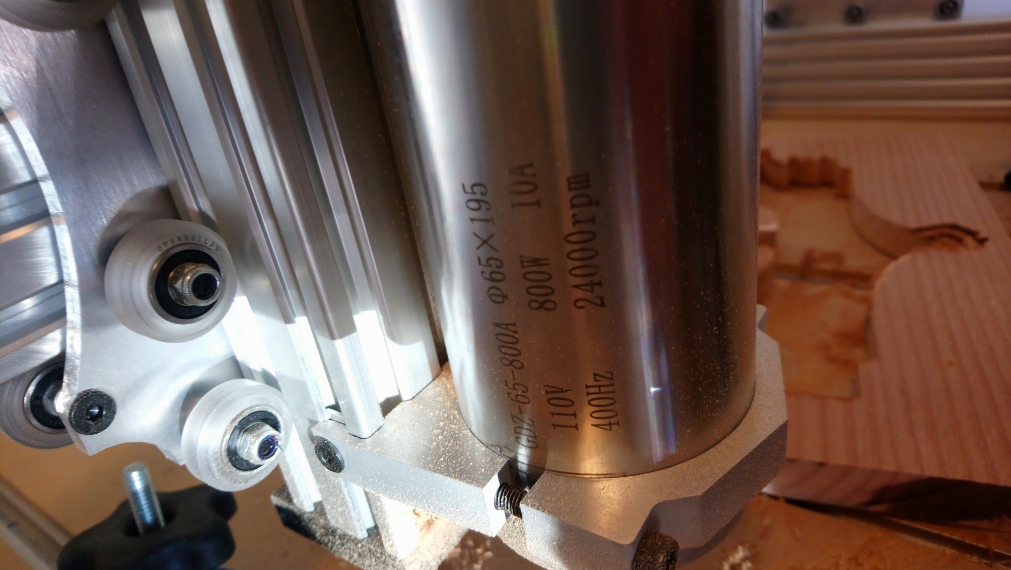

Here is my spindle, it is 10A max. Smw3d preconfigures the VFD for the 800W spindle, but the spindles on their site say 5A so I am wondering if my VFD is configured for a 5A spindle. The only change I’d need to make is raise the current limit, should I raise it to 10A? @Brandon_Satterfield
Ok, so another update. D1-05 shows that the “Inverter rated current” is 8A, and the spindle itself on the case says 15A next to the model number. I don’t see anywhere you can adjust the max current, only protection settings; ie, P0-35 lets you change the motor overload protection current between 50% - 110%.
I’m not sure if there is much I can change on the VFD, and I am curious at that max current 10A on my spindle. Does that mean it is not running at full power unless it is getting 10A? If my spindle was 800W and 5A, and I hooked it up this VFD that shows inverter operating current of 8A, that it would be getting more current than the spindle was rated for?

I have not done any measurements on my spindle. And, forgive me if I am telling you something you already know but I am going to start at the beginning. Watts = Volts x Amps. We need 880 watts to be full power. The Volts and Amps are not important as long as they add up to the right watts. 88 volts at 10 amps would be fine but so would 7.3 Amps at 120 volts. They work out to the same power at the cutter.
Hmm, in that case it makes sense that my spindle stutters. I have not measured it directly, but when cutting aluminum the VFD reports that the output current is 2.3A @ 55V @ 200 Hz, and sometimes it looks like my spindle stutters (but the current doesn’t change). That would mean that it’s cutting and stuttering with 2.3A * 55V = 126.5W, not even close to it’s max capable power.

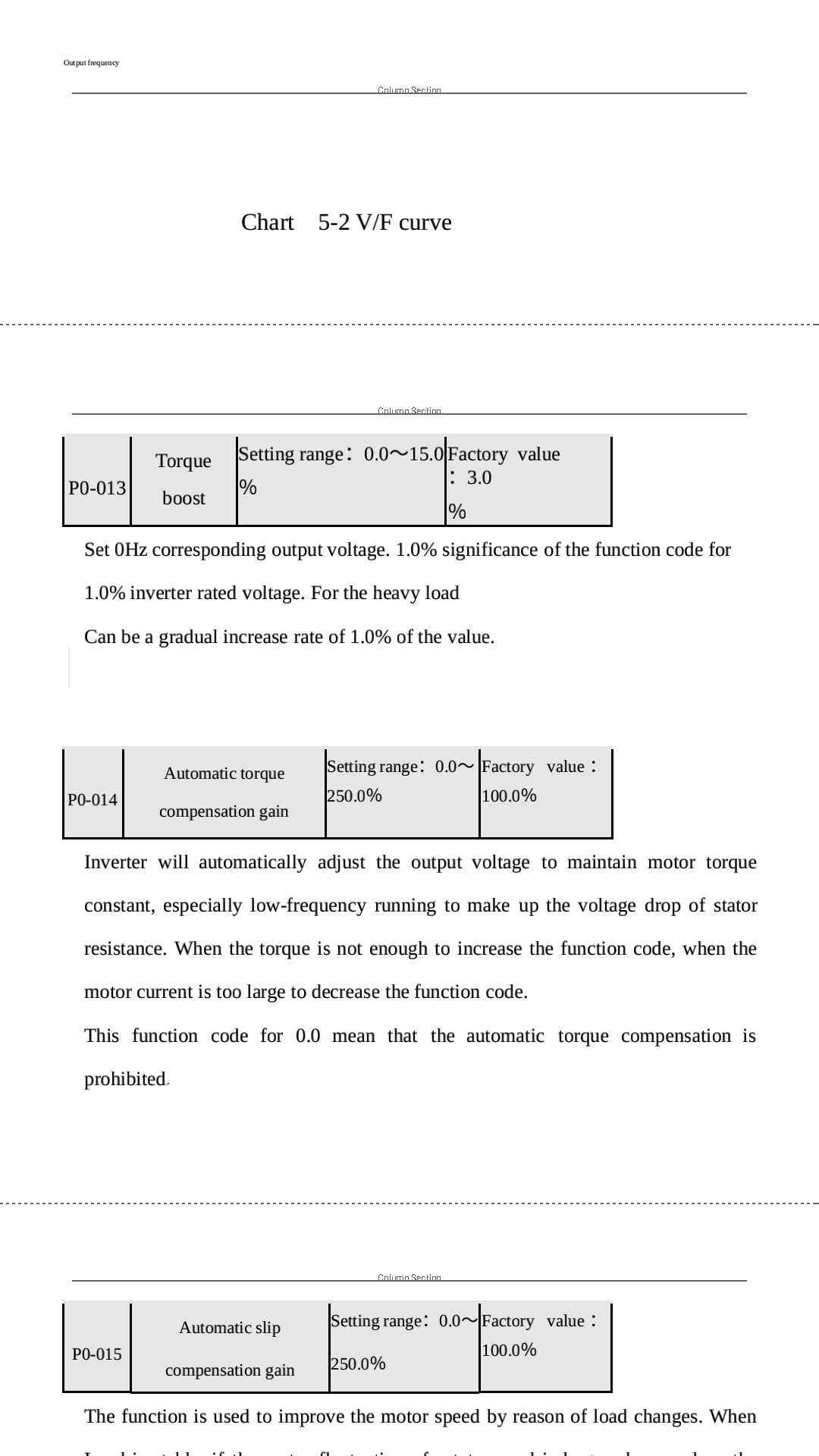

The NowForever VFD has a torque boost parameter that best I can tell boosts the voltage at lower RPM for higher torque. I might try this tomorrow and see what it does.
