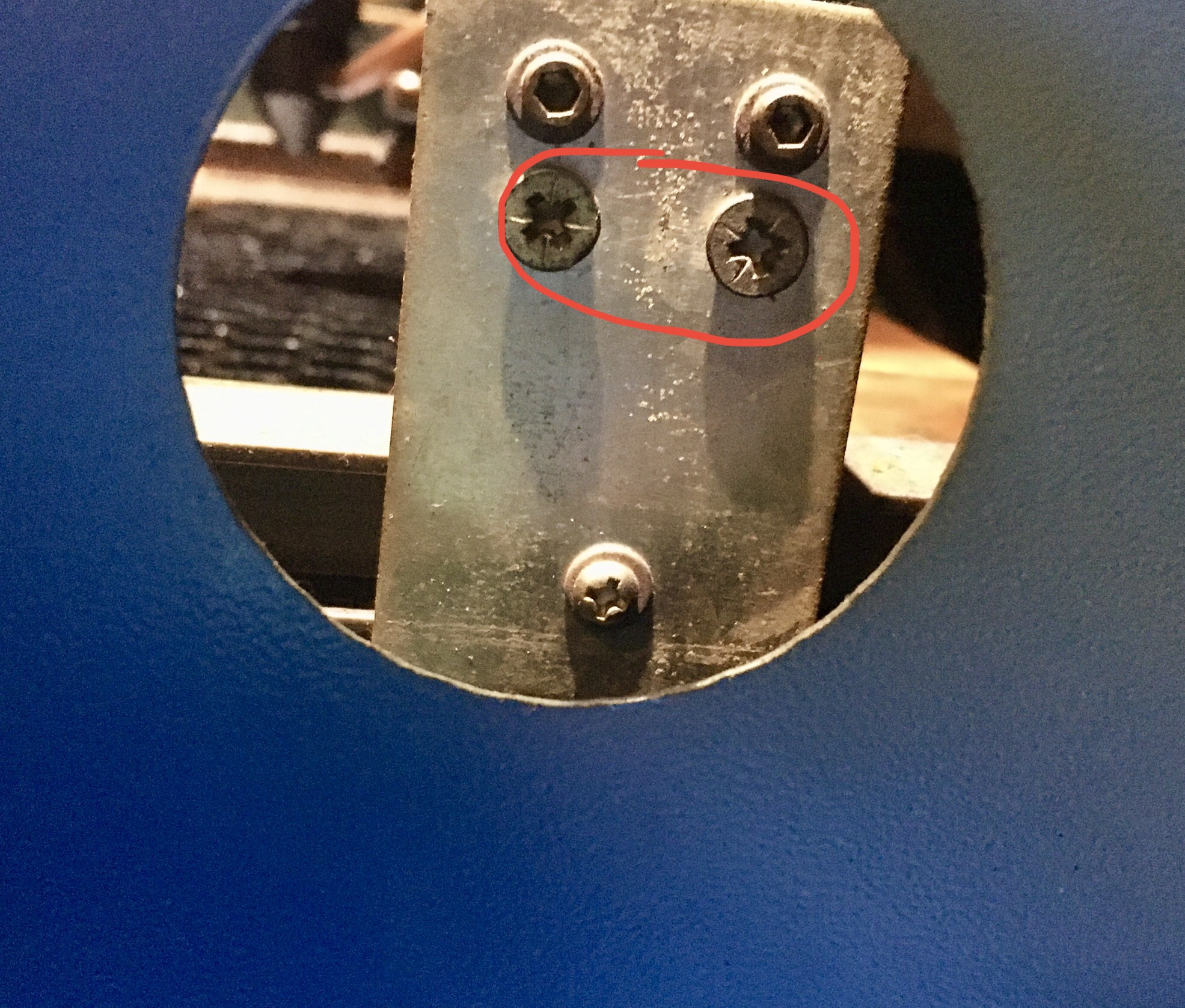

The mounting plate goes over the motor, around the pulley, with a section milled out for the belt to pass over. This means you have to loosen the x-belt and remove it from the motor pulley. If you haven’t worked with the x-belt, the belt tensioning screws are on the right side. You access the screws from a hole in the wall between the laser compartment and the LPS compartment. Loosen both screws, shown circled, about the same amount until you can remove the belt from the motor pulley.
Mounted the new mirror mount using 4 M3 x 15mm stainless steel hex cap screws with washers and reinstalled the belt. Be sure not to over tighten the belt which can cause binding.
