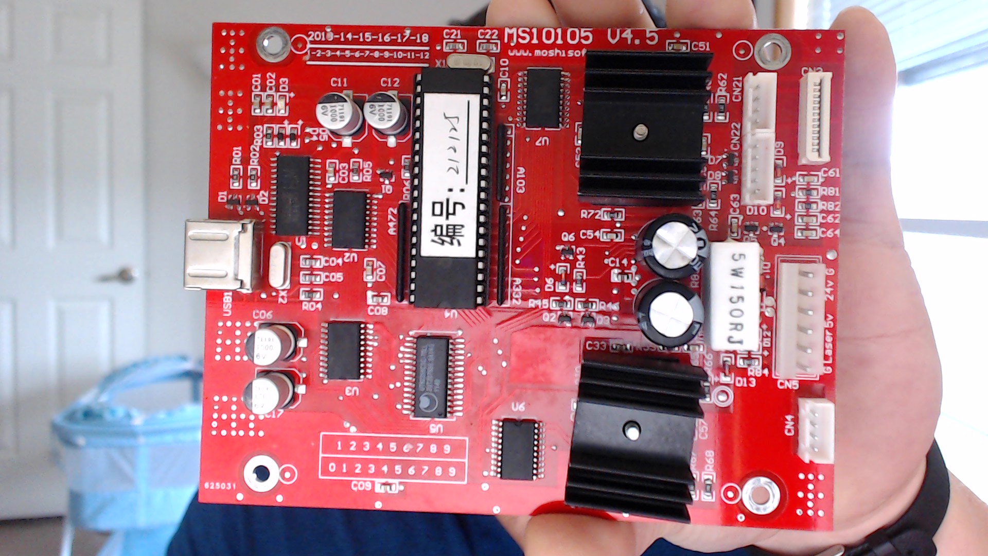

I was more thinking that you could have it, let me go look and verify it is actually a Moshiboard.
Found it tucked in an antistatic bag so it should be viable. Do you need the dongle also? If interested Message me your shipping info and how you would like it sent, preferably on your shipping account. Free is never free is it? :slight_smile:

Got the board from Joseph. Running some wiresharks on it. It’s very dissimilar to the M2 nano. It has memory, and the sends are not A0 they are A6 and A7 which is a direct memory write. It has weird routines like set A7 to this value then read (AC01) then reads that byte. It has a bunch of weird 3 byte command structures that sometimes group into like 6 or 7 command bunches. The running theory is that the M2 nano streams a bytecode interpreted by the firmware in the CPU to flip the bits. And the Moshi is literally streaming the bit flip binary, or it could be basically literally CPU commands in binary. And it’s just constantly pinging for the state, so it sends status requests several times a second. And the status byte is idle when finished and busy while it’s running, and shows that in moshi draw.
My dream of slapping something together in a few hours is doomed. I could likely just ask the chip for the any firmware it has and it would hand it over.
And this answers the question what a very primitive form of the M2 scheme would be.Though really the M2 is a bit more simple because it does the entire thing without any memory. It just runs that from the CPU cache.

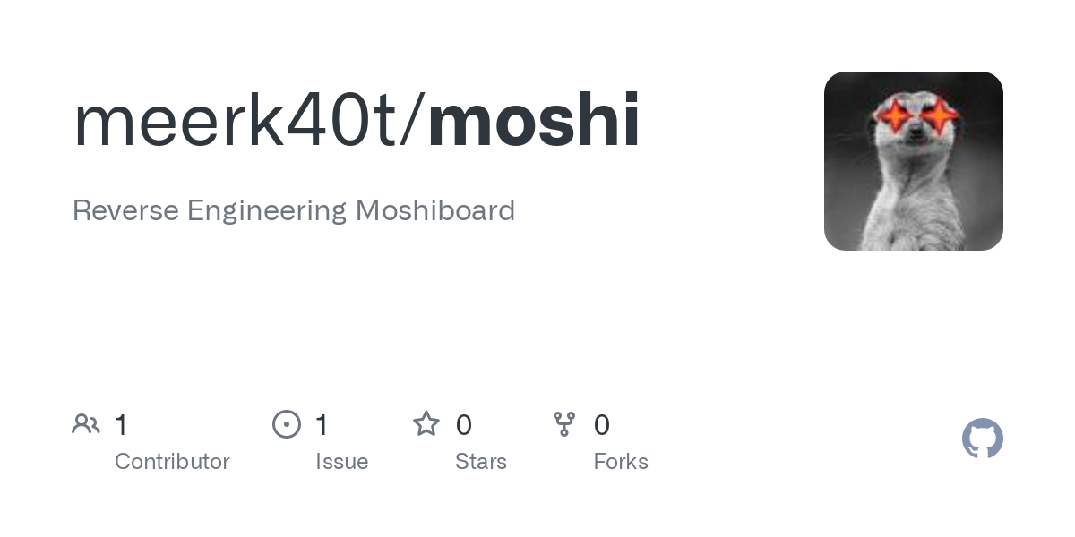

Made a github for the effort, including some of the major findings.
