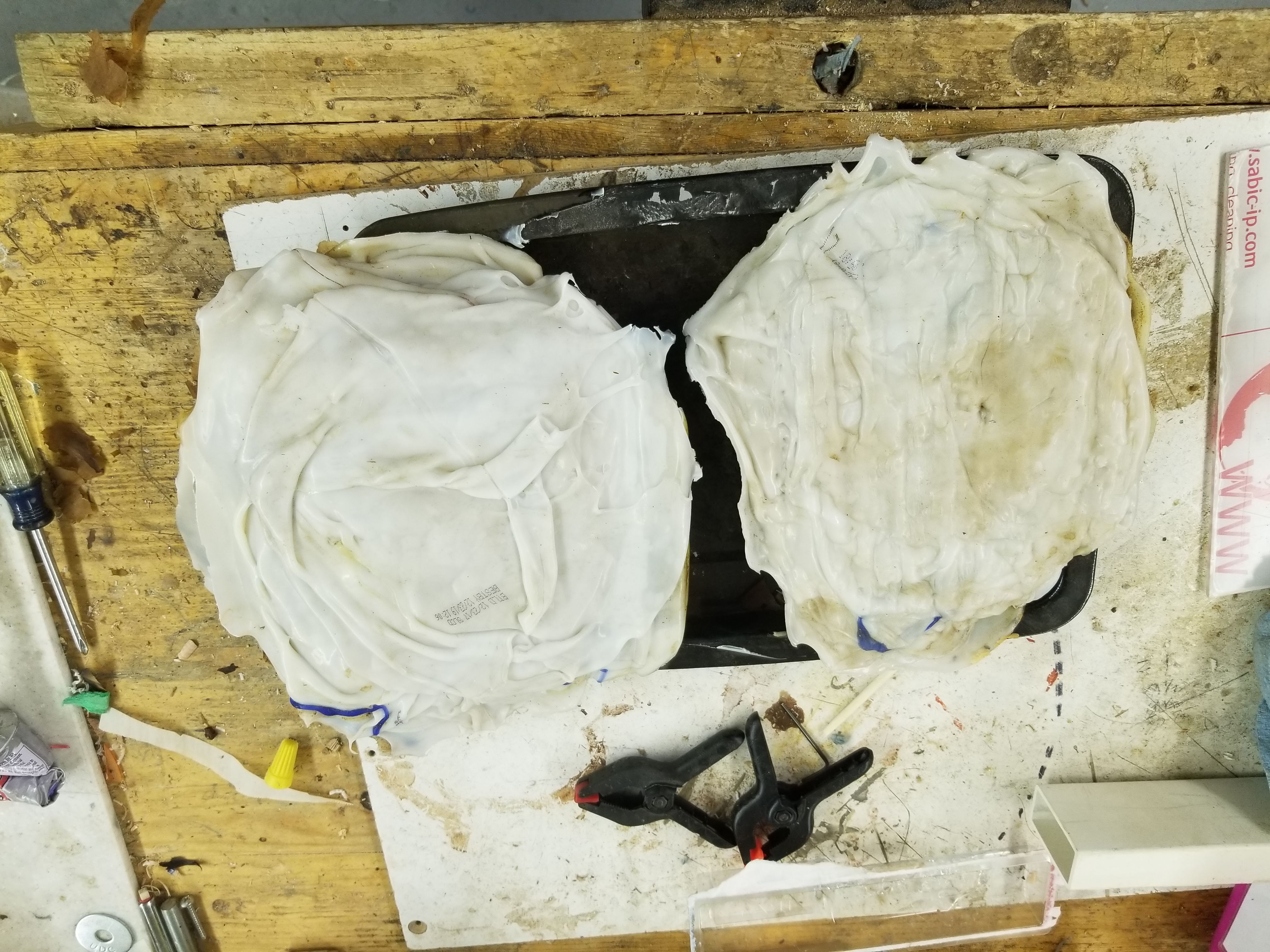

So far the simplest manual method seems to be:
  1. Cut the label out of the bottle with a sharp knife
  2. Lay a piece of oven paper on the ovens shallow tray
  3. Put the entire bottle in the toaster oven at 300-350 (tweak temp to prevent browning)
  4. After it melts to clear, keep adding bottles to make a layered slab
  5. Store the slab for later cutting and putting into a mold
[this seems to be easier than cutting the bottle into strips and blender-ing it. I can just keep adding bottles while I am working in the shop.]

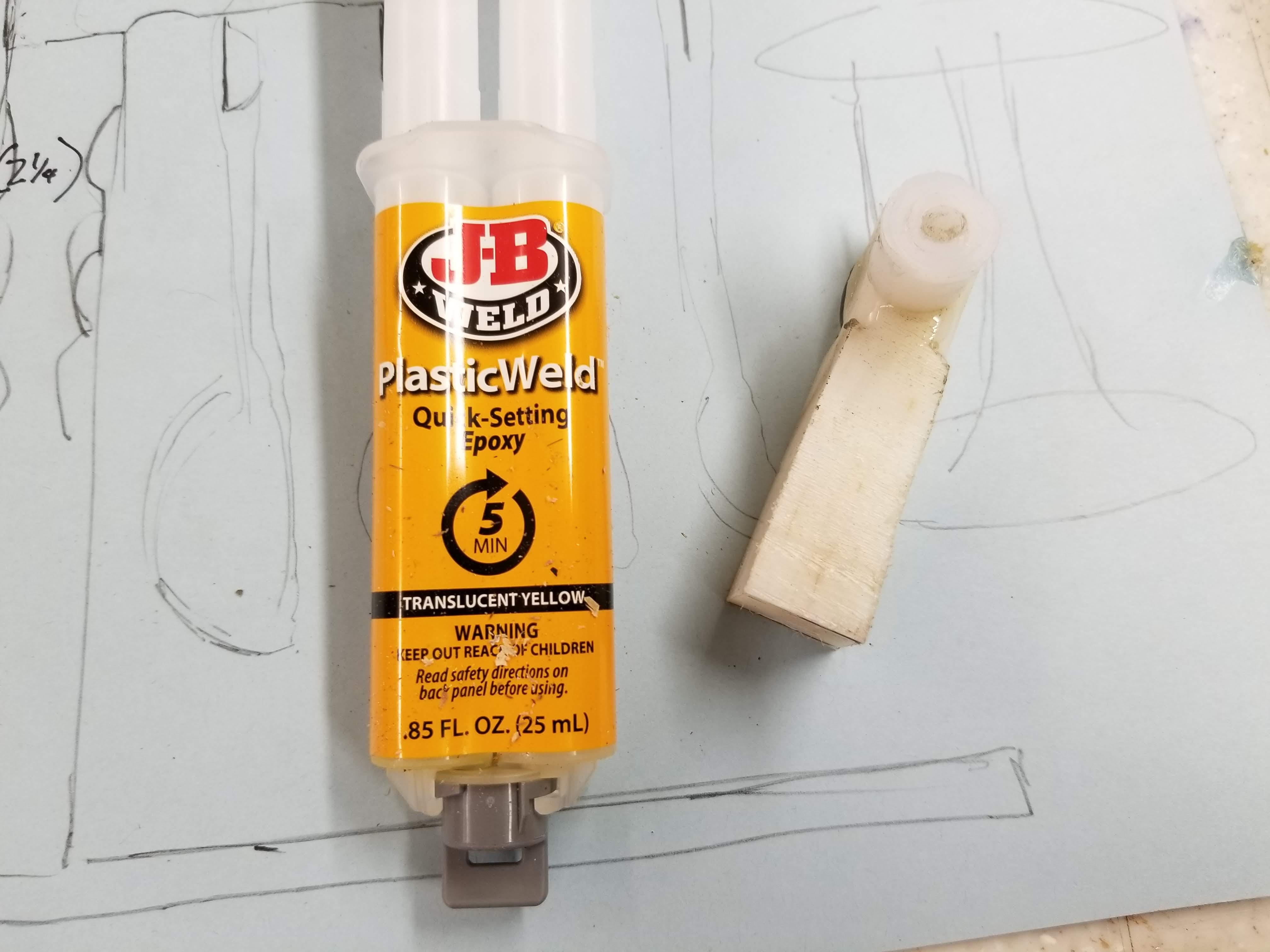

I tried some glue!
I got 2 HDPE sections and flash prepared them as @Roberbike suggested.
I then used JB Weld plastic epoxy [Wallmart] to glue them together. This glue showed up when I did a search for TAP Poly-Weld Adhesive on amazon. Not expensive.
Surprise;
It made a really strong joint [qualitative] between two flash-prepared sections of HDPE. I could not cause it to fail by hand.
I also tried two pieces of PVC pipe [I have tried to glue PVC before] and it made a pretty strong joint [qualitative] that I could cause to fail but with a lot of force.
Thanks for the advice now I have a new gluing tool in my arsenal.

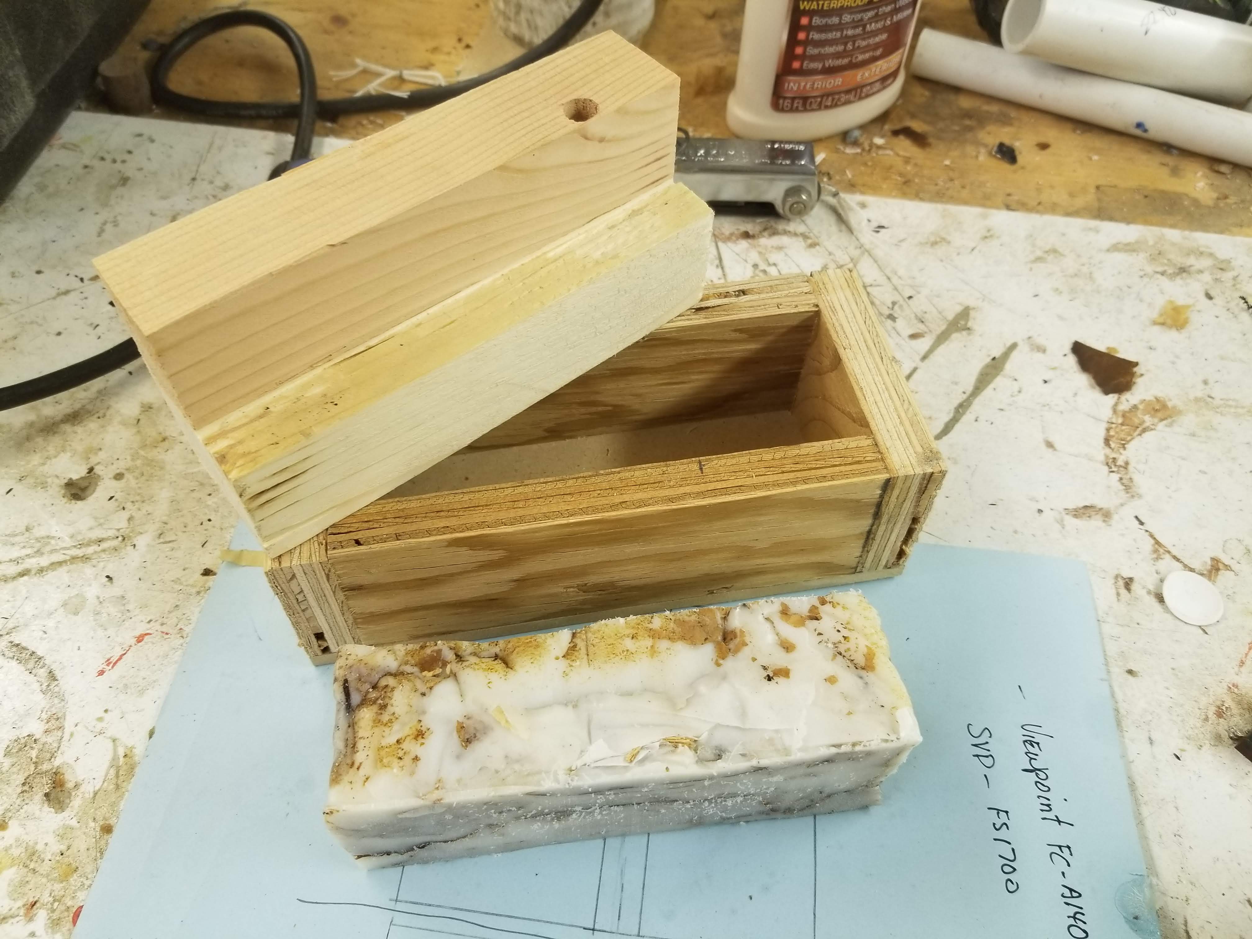

Pressing the molten plastic to a form seems to work:
I combined the methods described above and I am getting to a point of usable molds.
Now:
  • Cut the label off the bottle with a utility knife
  • Stomp on the bottle
  • Put in the toaster oven on a piece of oven paper @ 300 degrees
  • Pull out when it gets clear
  • With oven gloves peel off the oven paper and force into the mold which is lined with oven paper.
    {this stuff is really HOT and STICKY}
  • Put plunger into the mold and tighten in vice
  • Let cool
  • Take out of vice, Blank drops out
Not pretty but I think it will turn ok!
