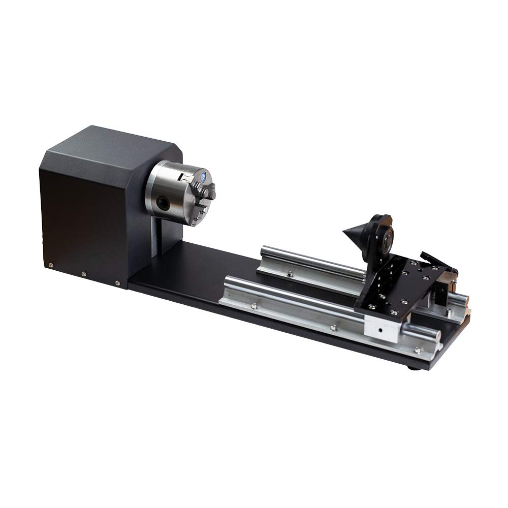

Do you know of a rotary that is adjustable for shot glasses and that it’s able to engrave all the way around a beer mug that has a handle? I just ordered my machine thank you for all your support
I purchased the rotary off eBay. Just do it look on eBay and see if you can see something that will fit your bill. You just might need to purchase a couple of different rotary attachments to get what you need.
@HalfNormal
Would you know if this is compatible with the 60w laser engraver
No link
Looks like it will work. You will need to get the correct connector or make a cable to interface it to the laser. It is a screw on connector to disconnect the y axis and connect the rotary attachment.

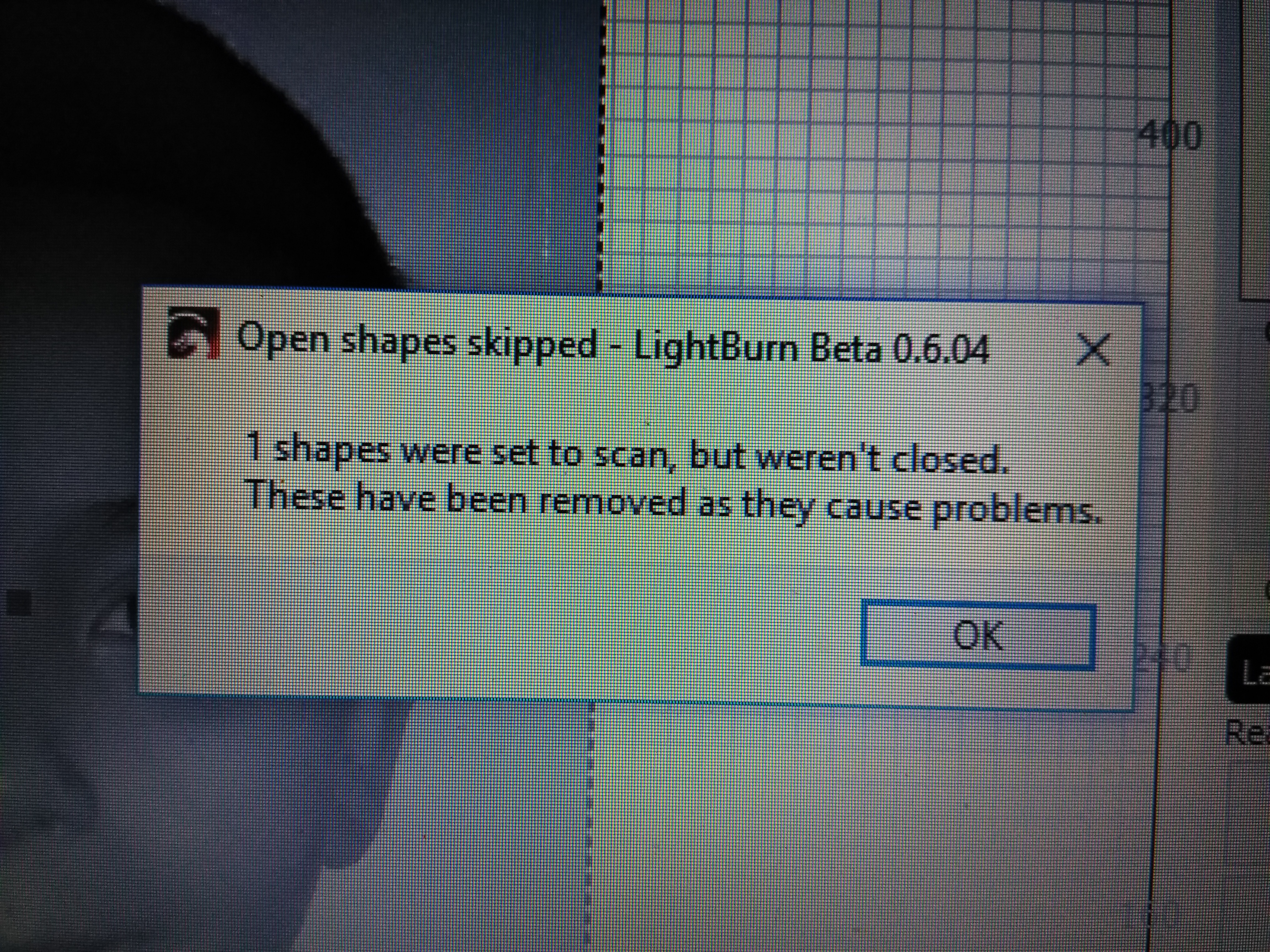

Thank you so much for your help you same me from a big headache. Would you know why every time I put a picture to engraved it pops up this message
You are welcome. Happy to help when I can. I am unfamiliar with that error message. The fastest way to get help with lightburn is on their facebook page. I did try a quick google search and came up empty. Please let me know what you find out.
I restarted the program and it worked good that message only pops up when I import certain pictures. What’s the fastest speed that I can run it? And what the most power I can run ? For safety
There are always a lot of variables on what works and what does not. The lowest power is always the best for safety. Speed is relative to the material and expected outcome ie lighter or darker and type of material. Remember that what worked once on a certain material might not work the same again due to natural variations. I always work with scraps before committing. I wish that you could just set and forget but that is not how the laser works. Keep working with it and it will come easier to find what works most of the time. Most of all have fun!
