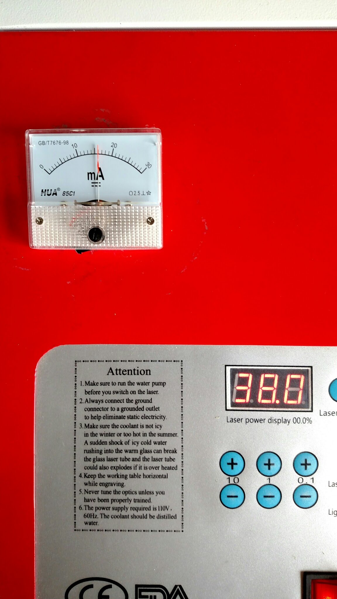

Put in a new tube, aligned and testing. 38% power = 16ma. Not sure what to think.
@Mark_Harper lets make sure the panel is working as expected. When you set the power to 50% what voltage does the IN pin on the LPS read to ground. Should be about 2.5VDC?
2.95vdc at 50%
