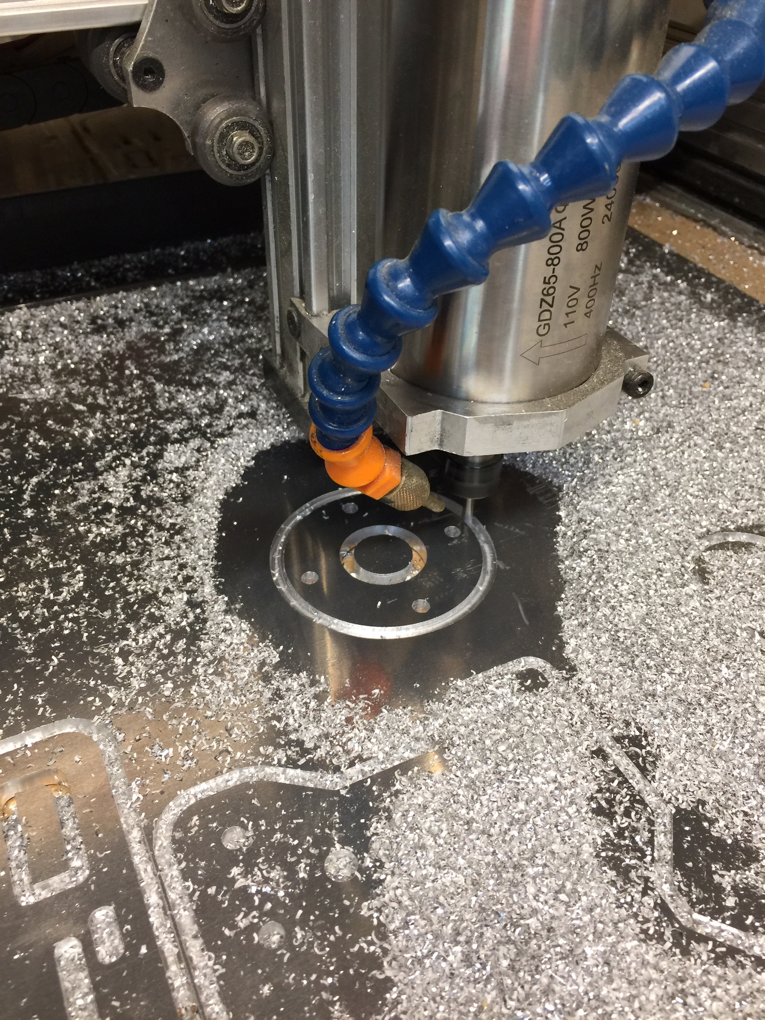

Ok I'm stumped. After spending the day resurfacing my spoilboard,
Seems so strange to have to put a sacrificial aluminum sheet down to cut this. I see you doing this sort of cut daily Brandon so I’m just totally confused as to why this is something I’d have to do, and it’ll get might expensive having to do that for all the pieces I need to make.

Hey bud looks like your cutting the outside of the 28mm hole. You want the ID open correct to install the bearing?
@Brandon_Satterfield don’t think I am, I’ve dropped the bearing into one of the bad cuts before and it was just about right, a little tight but good. Oh I just downloaded the file and I think I see what might have happened, I had a style reference for the cut, and it pops up a window when you load it if you’re not careful that reverts it to Outside cut… let me clean up that file.

@Brandon_Satterfield just uploaded a new copy of that file to the drive. Fixed now, should load cleanly and show the inside cut.
@Steve_Popmarkov that is true, although you are assuming even thickness of the cardboard all across. Also, why the hell would cardboard work where MDF causes the issue? I don’t see the cutter having any trouble cutting up the MDF, so why would cardboard be better?

@Ben_Delarre video uploading now. Changed DoC to .6
Target depth -6.8, plunge was OK at 5. Tabs ok as well.
Posted a video. Part about done.
Ok, so its not the gcode, and its not the touching the MDF…its clearly something mechanically not right with my machine, or my controller?
About done
This machine is old as dirt, loose everywhere. Same end mill. Factory collet.
