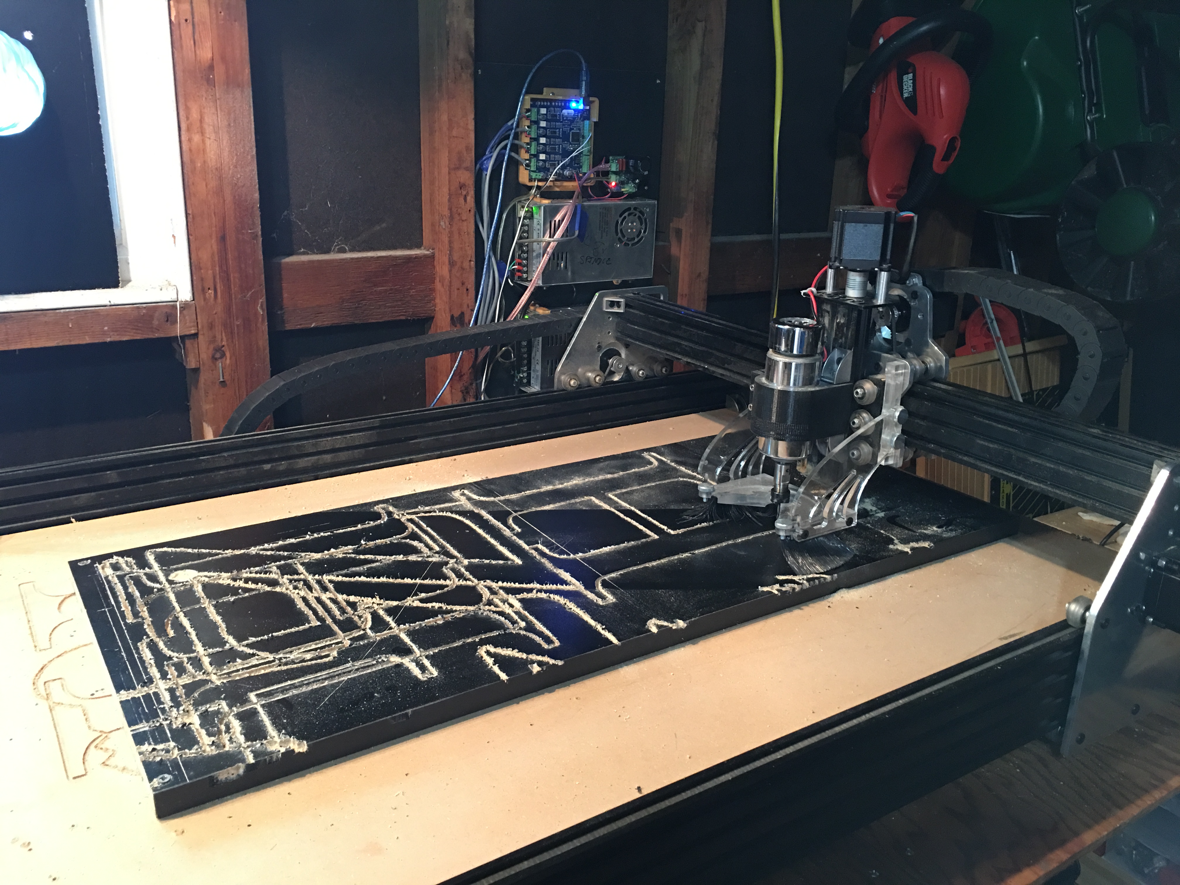

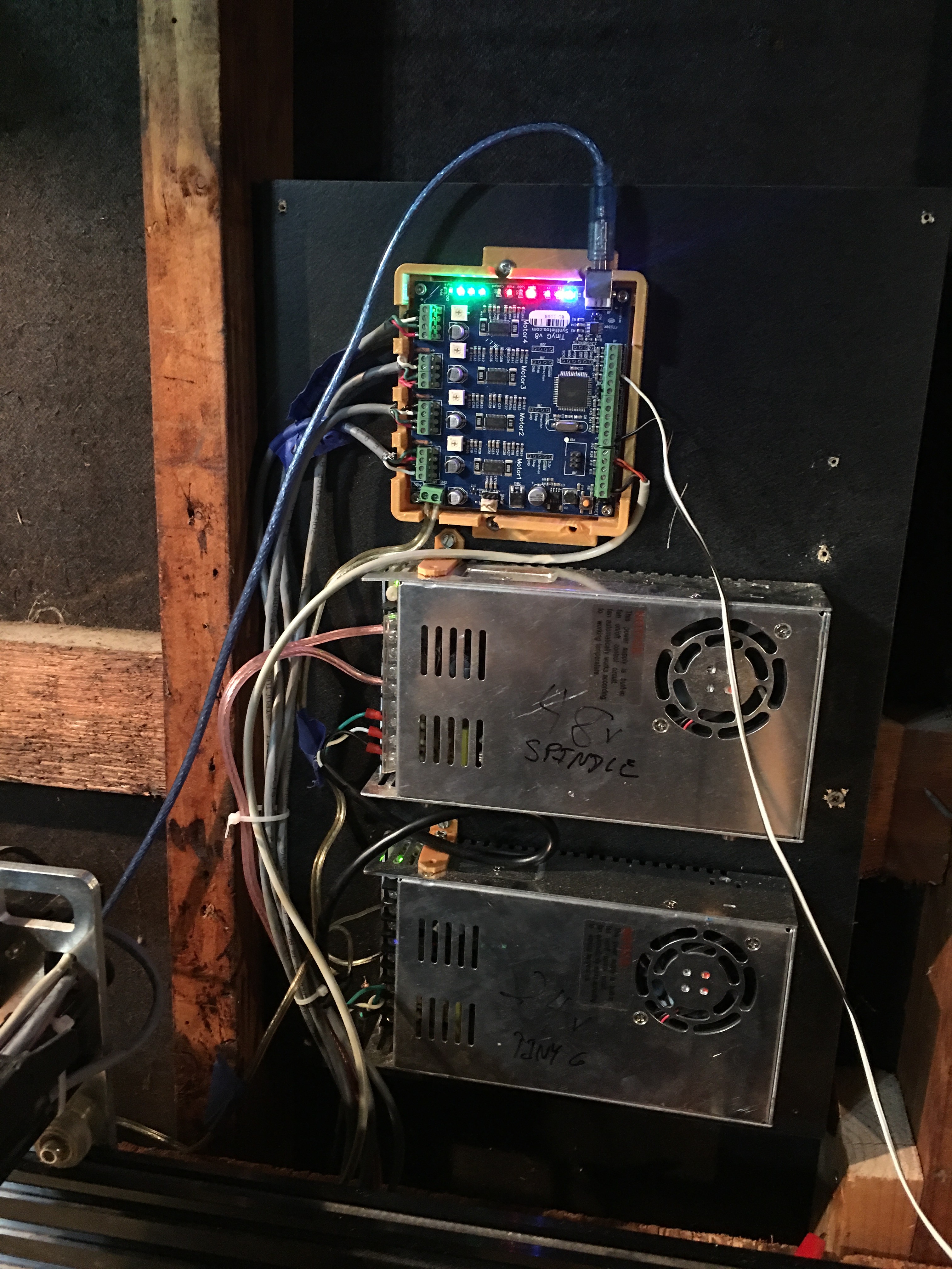

@SirGeekALot it looks like your controller is hanging on the wall away from the cnc in between the 2x4"s? Hard for me to tell in the photo. How long are the wires?
That said you have nothing connected to the end-stop connections on the tiny G right?
You can also try grounding the end-stop signals at the connector just to insure nothing funky. Probably not since they are turned off.
I doubt your problem is radiated as it seems your controller is pretty far away. So don’t think a shield on the controller would help.
My guess is your problem is conducted noise through the power supply grounds.

How are your power supply’s grounded did you use a single point ground schema as I suggested in my long post?
Hard to tell but I do not see the grounds on the 24V and 48V supply grounded to each other and to the safety ground.
If not find a single metal place to bring them all to with a good size wire.

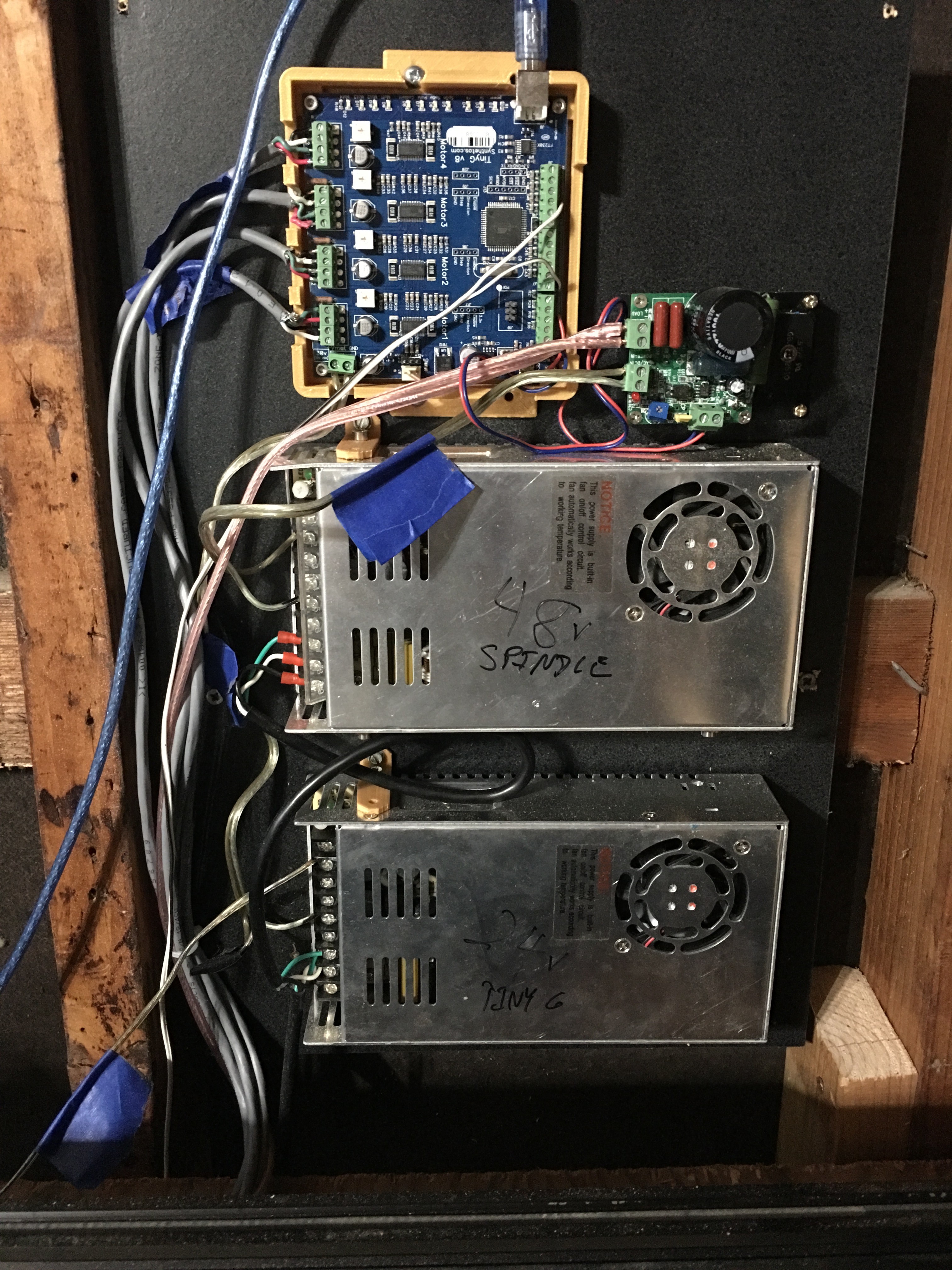

@donkjr I’m not 100% sure on the TinyG LEDs, but I think they were in an error state. The failure is never in the same spot (or I would suspect the gcode was messed up). The failure always manifests itself as movement halted with the spindle still running, and the system is always unresponsive. I have both power supplies on the same power cord, and that is the only ground. I’ll attach a better picture of just the electronics in just a second.
Also, the main house power circuit breaker panel is just to the left of my K40 laser cutter, which I have used a wire to ground directly from the K40 ground post to the same ground my heat pump (on the other side of that wall…hmmm) uses which is the pipe on the power panel.
Is there any place your wiring is crushed, bent sharply, nicked, or any connections on your board / motors that are loose? How tight is that zip tie on your gray motor wires?

Note: my electronics are mounted below the cnc and close to the motors, sensors and gantry.
The spindle motor driver is on the gantry so the only 48 line going through the drag chain is the supply. The motor drivers output is a short wire from the motor control to the motor and does not go near any other wire bundles.

@donkjr 1) perhaps it was not clear in my photo, but the 24v and 48v power supplies use a single power cord wired in parallel, so they already have their grounds tied together.

The power cord safety ground is not the ground I am talking about. Although continuity-wise they may be connected they also may create a long return path for high currents. I am literally suggesting connecting a single wire between both ground lugs irrespective of how the safety ground and AC is connected.
This sounds nuts as a meter will tell you they are connected. This kind of problem is not a static one its all about insuring high speed currents flowing in inductors are following a short and predictable path from source to destination and back leaving as small a transient voltage drop as possible. -
I am trying to get all the source supply grounds to exactly the same point (transient potential) and not let those currents flow through other paths. You want to make sure 24v and 48 v current flows directly back to there sources (power supply) and are no way shifting each others ground. If they are connected to the same physical point their grounds have to be the same potential.

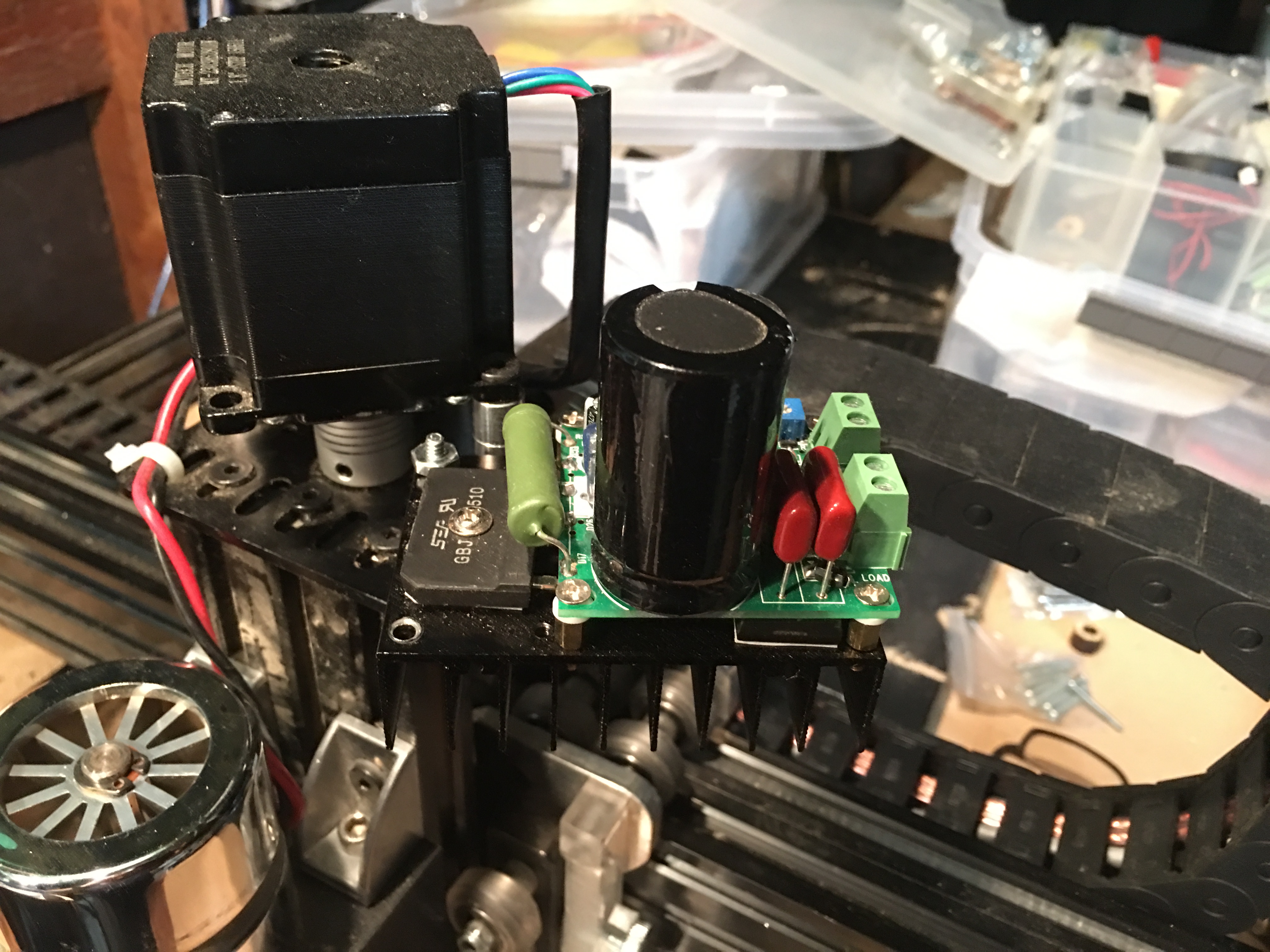

@donkjr it would be pretty easy for me to relocate the spindle driver by attaching it to the plate on top of the z axis extrusion (see photo). Acceptable, or too close to the spindle and/or stepper motor?
Relocated spindle speed controller to gantry. Running a test now (the job I’ve been trying to finish).
@SirGeekALot I think you would be ok with that gantry location noisy motors next to noisy motors are usually ok.
