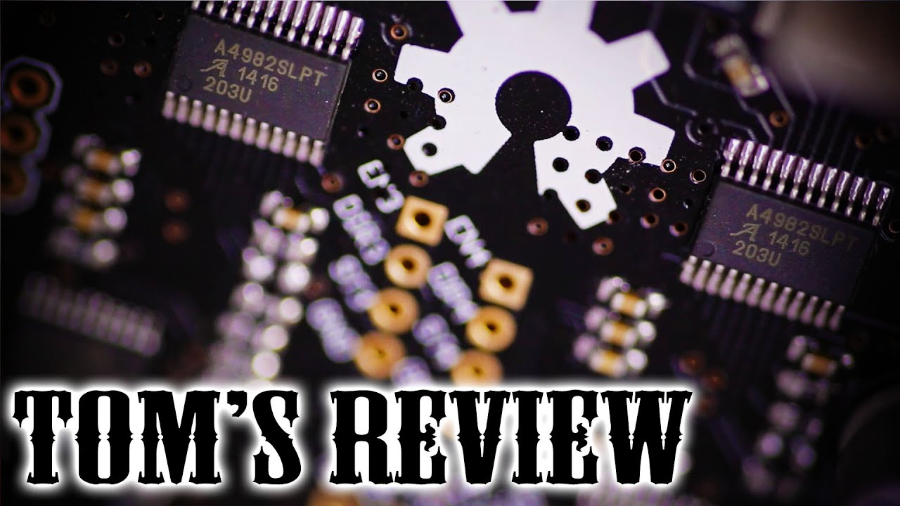

Also, don’t take it from me, watch @Thomas_Sanladerer 's video about it:
