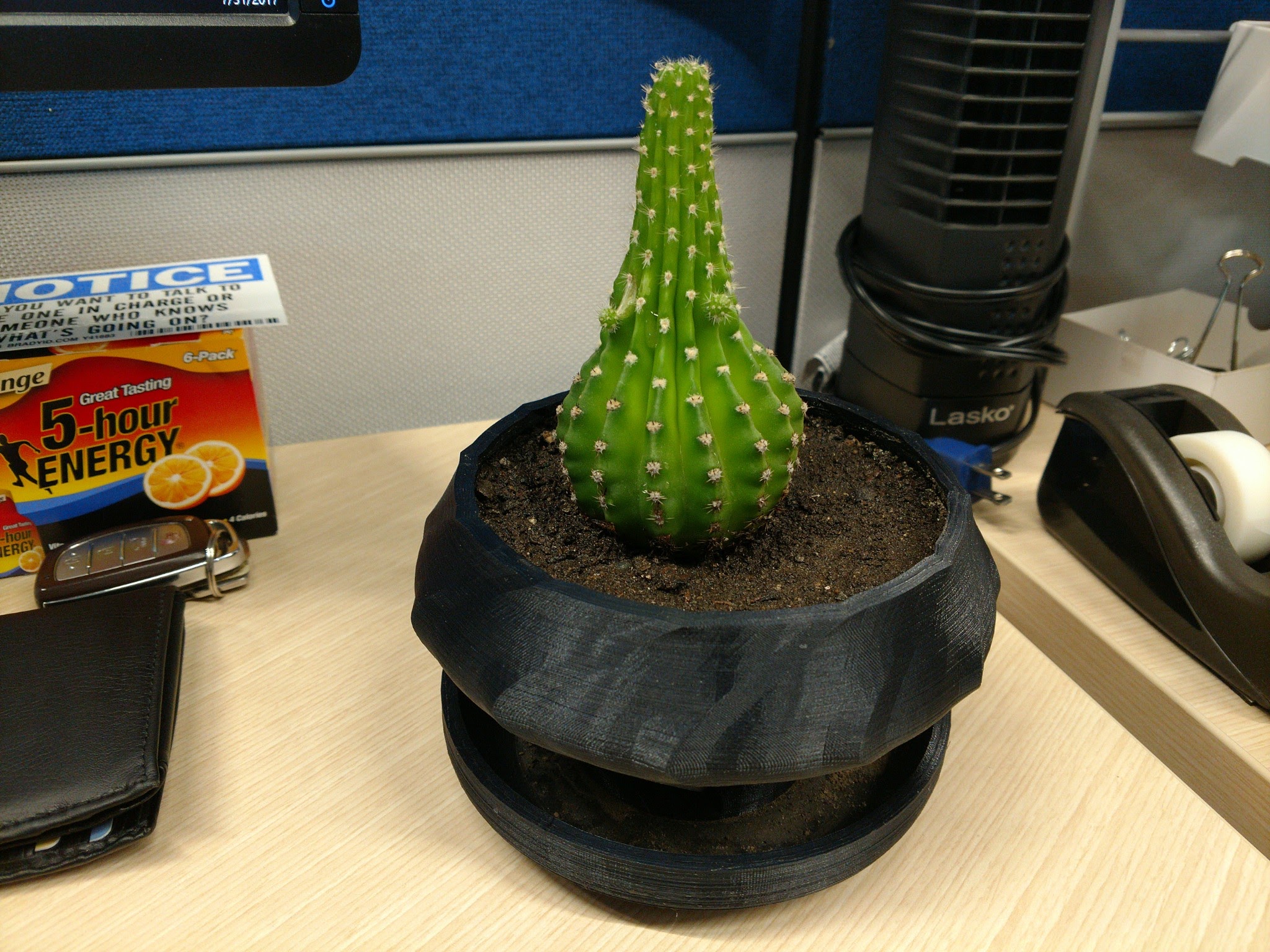

@rubin_kingma well my printer isn’t huge but I’ve printed a cactus pot that was about 6" in diameter and it came out great.
