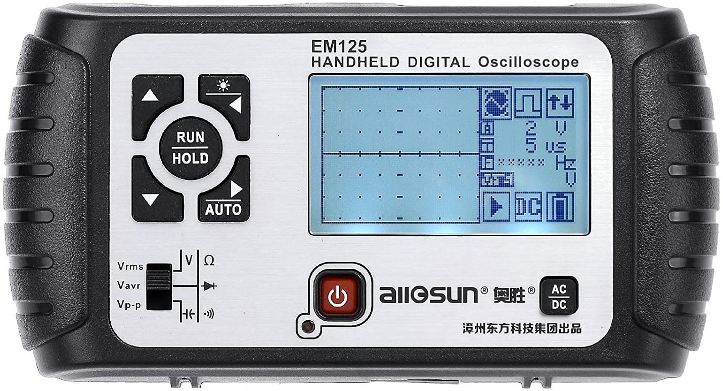

@Ryan_Cush I’m not the person to ask. But after doing some research I think I’m going for one of the cheaper 1000 or 2000 series oscilloscopes from Rigol.
I wonder if one of these would work? The first one says horizontal resolution is 10 ns/div.
