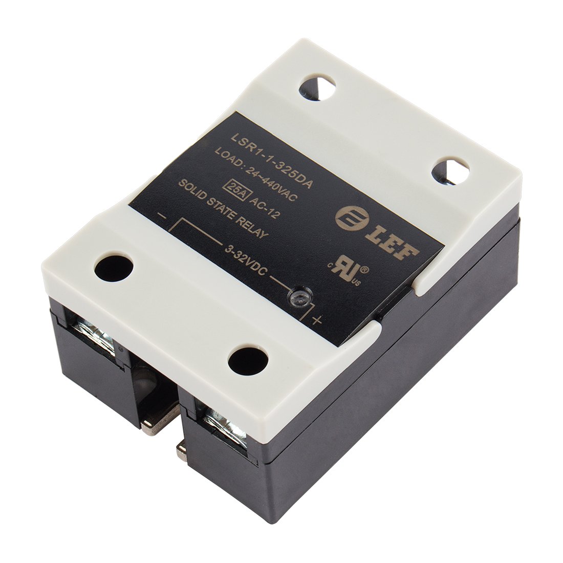

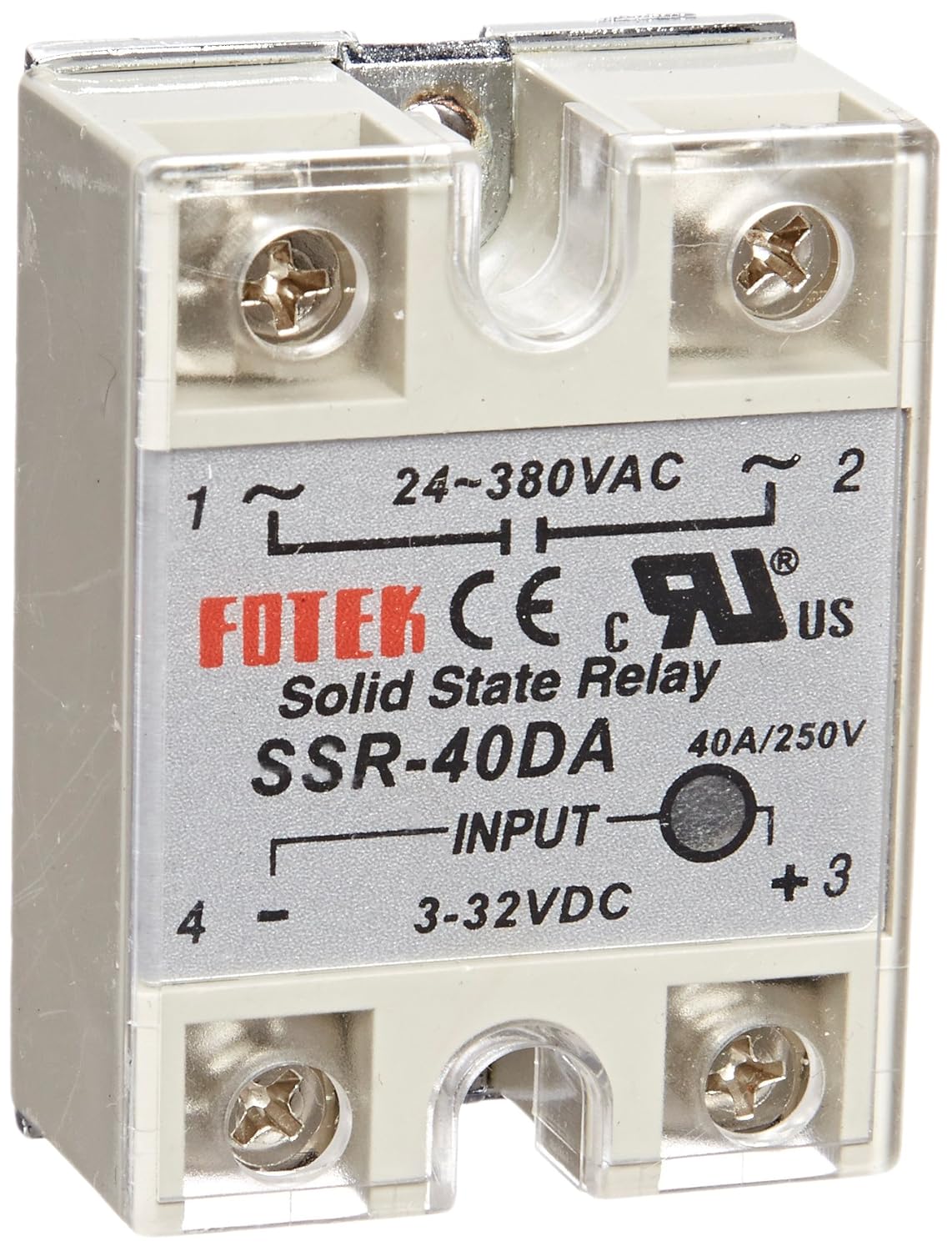

Wow, $5 for a 25A relay…3-32vDC input, 250V switch…very nice.
@ThantiK yeah, I saw that one, then I saw a 40A for $5 more and said, why not?
