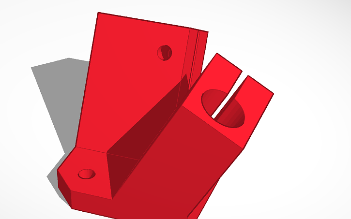

The Tinkercad pages for the top and bottoms bits for a simple truss are
At present it has poles at 30 degrees from vertical but I think 20 - 25 degrees to make it a bit taller may be better. I’m getting my prototype done first :slight_smile:
It is indeed very rigid, I have aligned telescope mirrors within 0.1 mm using these sort of trusses and they just stay put, no vibration, zero flexure and cheap to make
