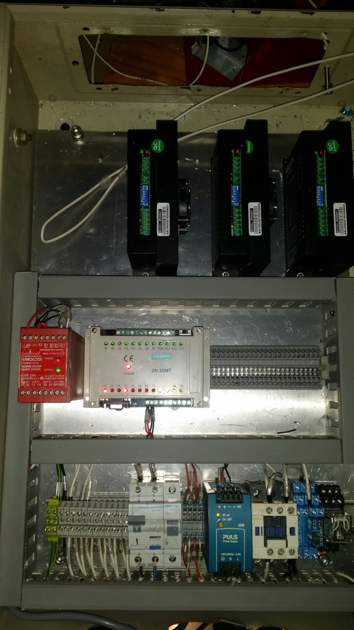

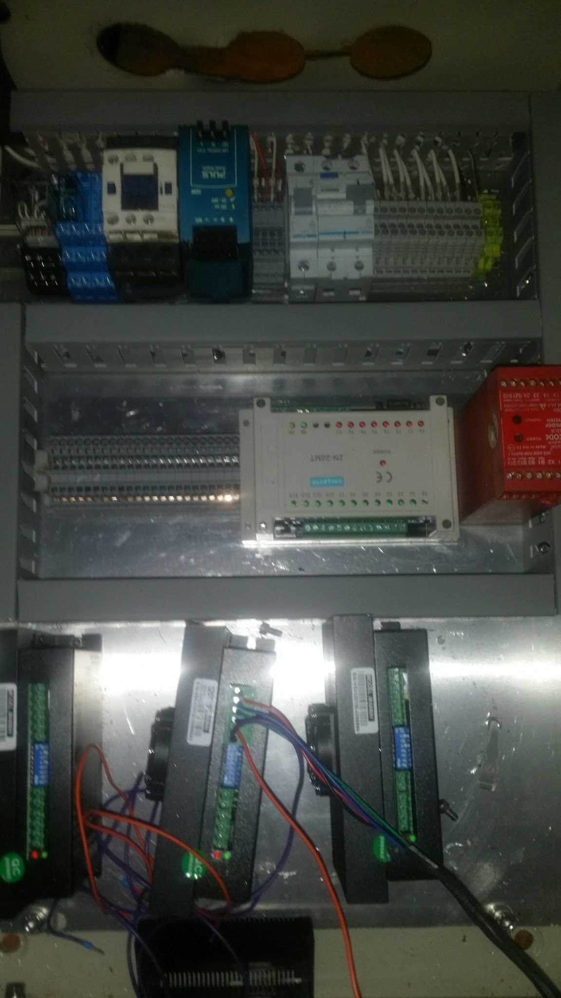

I had a few hours before work tonight so I added in the din rail and slotted duct. I optimized the components to keep the mains voltage confined to the lower section as much as possible. This is the final layout before wiring. As you can see I still have to fit the MA860H stepper drivers. I would like to have four of them eventually to drive an A axis. Thanks for all the motion control tips they really save me a lot of experimenting.
@Jim_Fong I checked your board out and it looks very good. I may use it on my next Laser.

@Robert_Ritchie from what I’ve read, those MA860h drivers are really good. Suppose to be even better than the Geckodrives I use. I need to buy one to compare/test soon. I have dozens of different stepper and servo drivers collected over the years. I use geckos since they have been really reliable for me, I have about 15 of them. The only time two died is when my house got hit by a direct lightning strike. Gecko replaced them for free even though they were about 8 years old. $$$$$$$ in other electronic equipment went up in smoke too.
@Jim_Fong Yes I have tried a few different stepper drivers and the MA860h is the best I have found so far.
@Robert_Ritchie Absolute nice work, very professional!

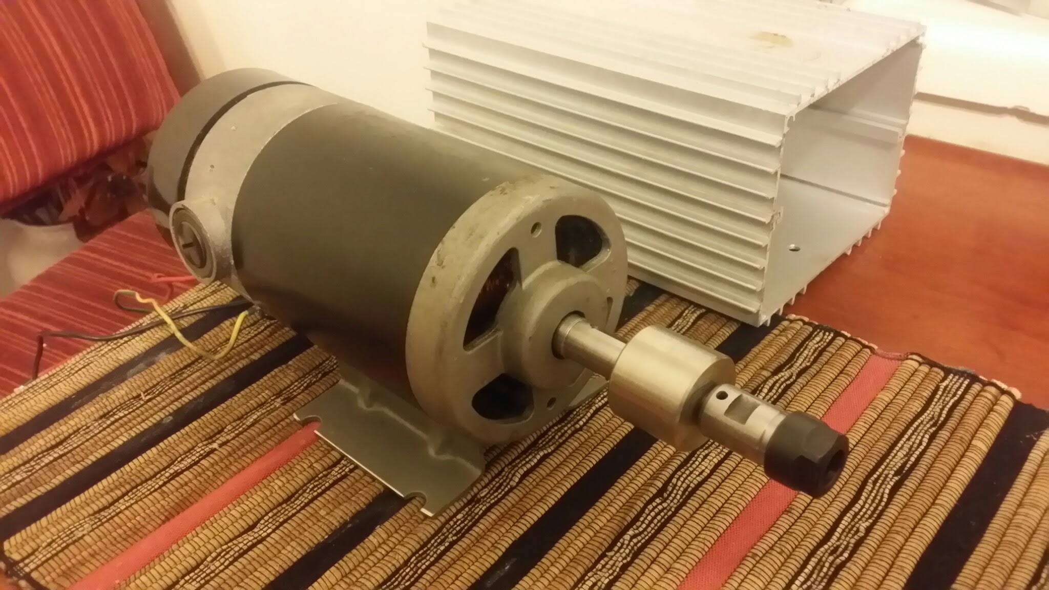

This is a 230 Volts DC motor I plan to use for the spindle that I will fit into the finned alloy case I believe it is rated at 2000 watts. The chuck is an ER16.
How would you control the motor? Only on and off or with speed regulation?
@Peter_Spiess I have a speed controller that has a manual knob that I am planning to build an interface with the Mach3 BOB.
Max safe speed is 6500 rpm.
Has your interface an 0 to 10V input for speed controlling?
@Peter_Spiess That is the idea to use the PWM 0-10V output from the Mach3 BOB then optically couple that to the 100K Ohm variable resistor that controls the speed.
