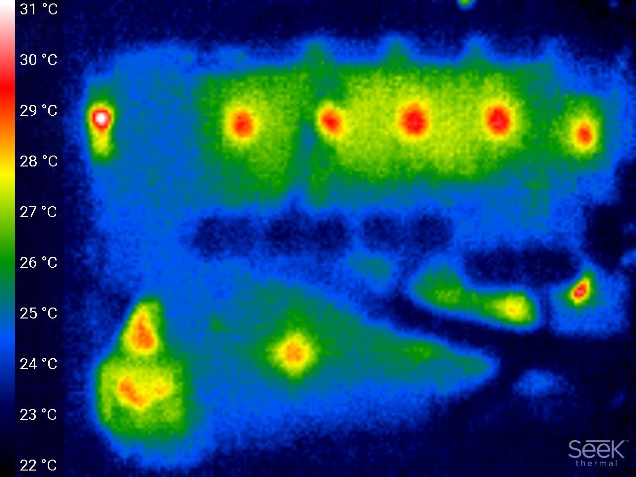

This thermal image is just of the drivers moving the print head slowly around the build volume. Seems fine to me, the white hot object is the power led
