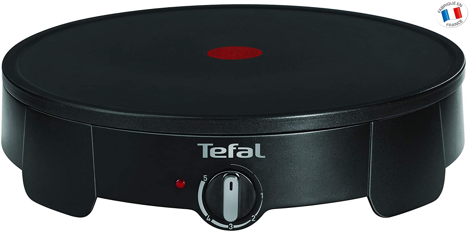

Did someone ever try something like this:
:stuck_out_tongue:
