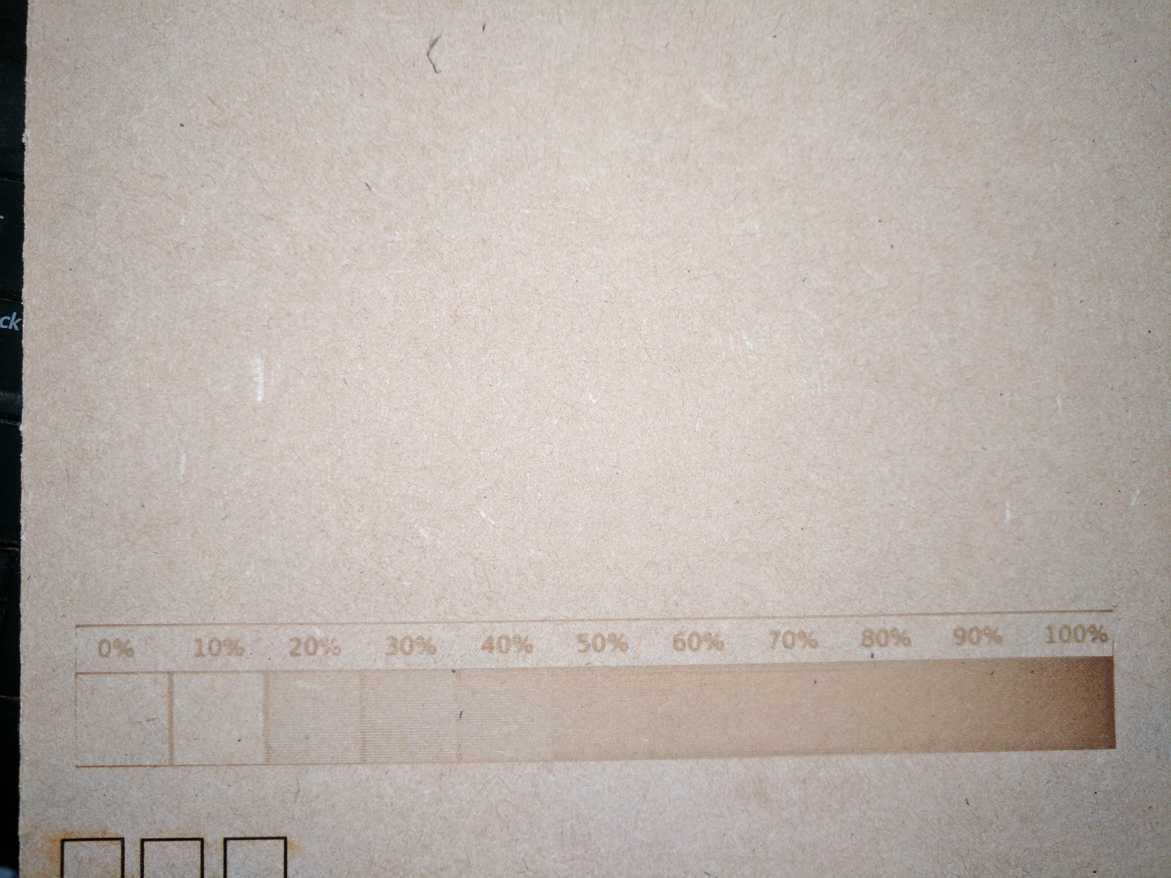

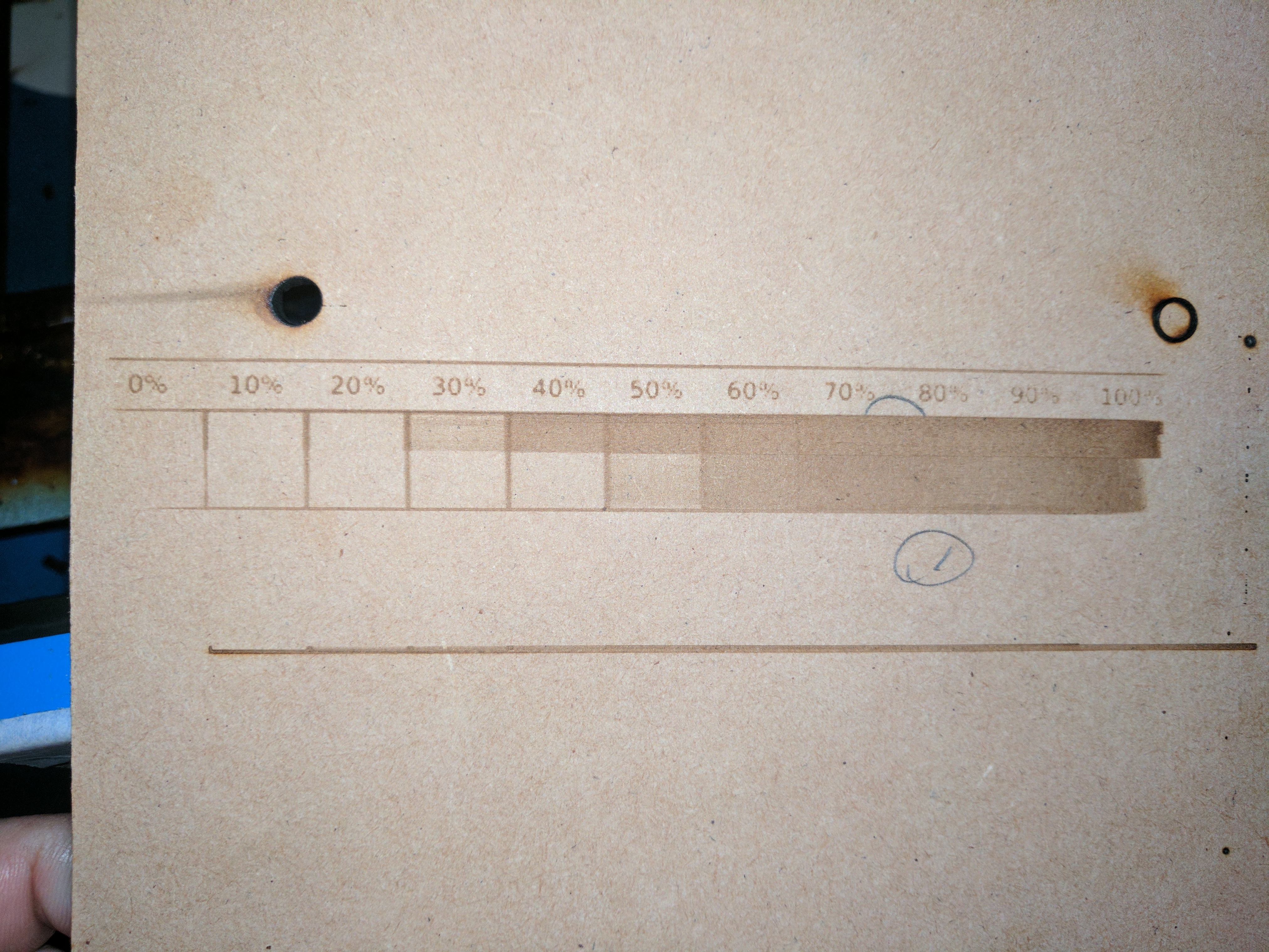

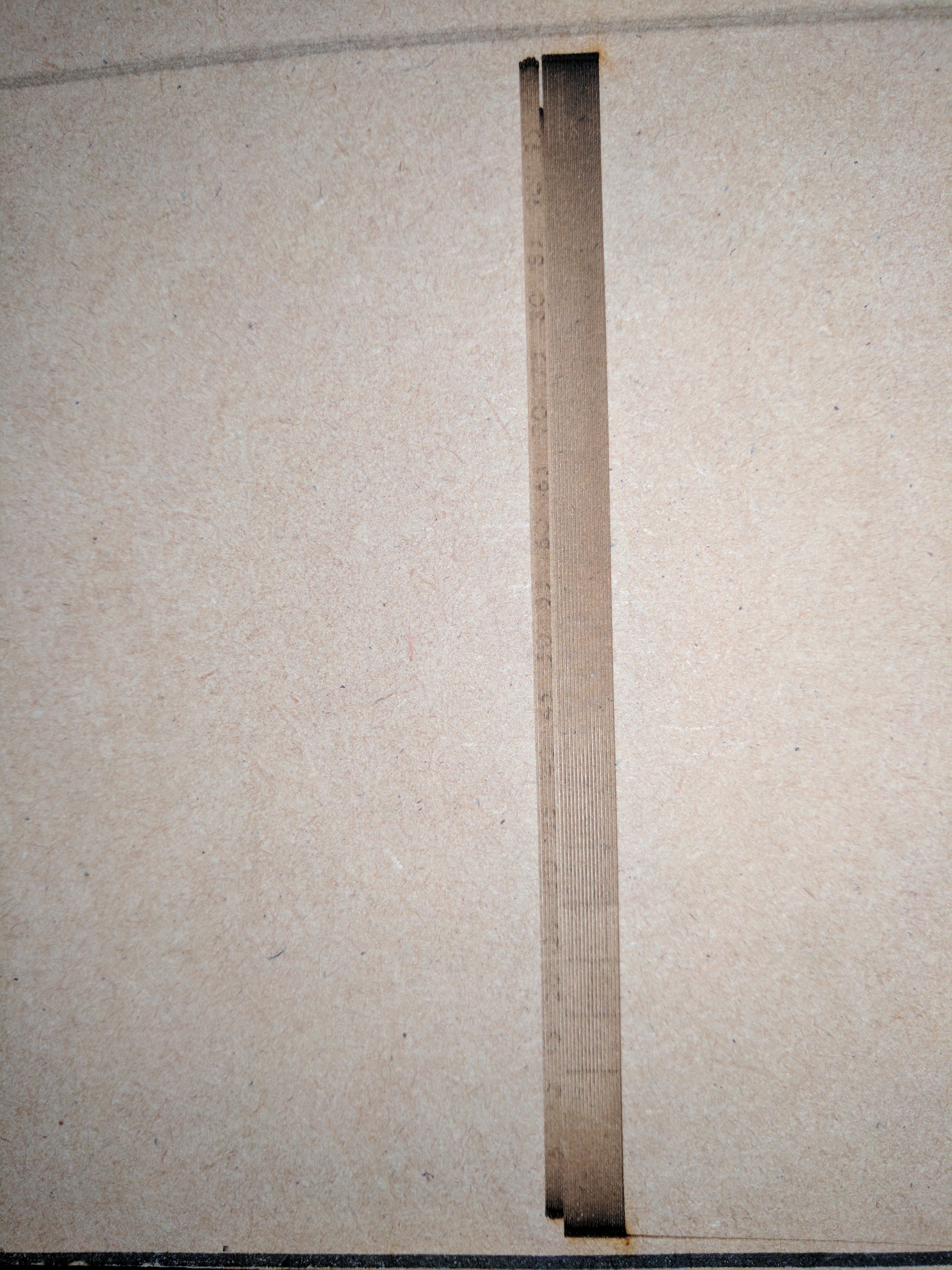

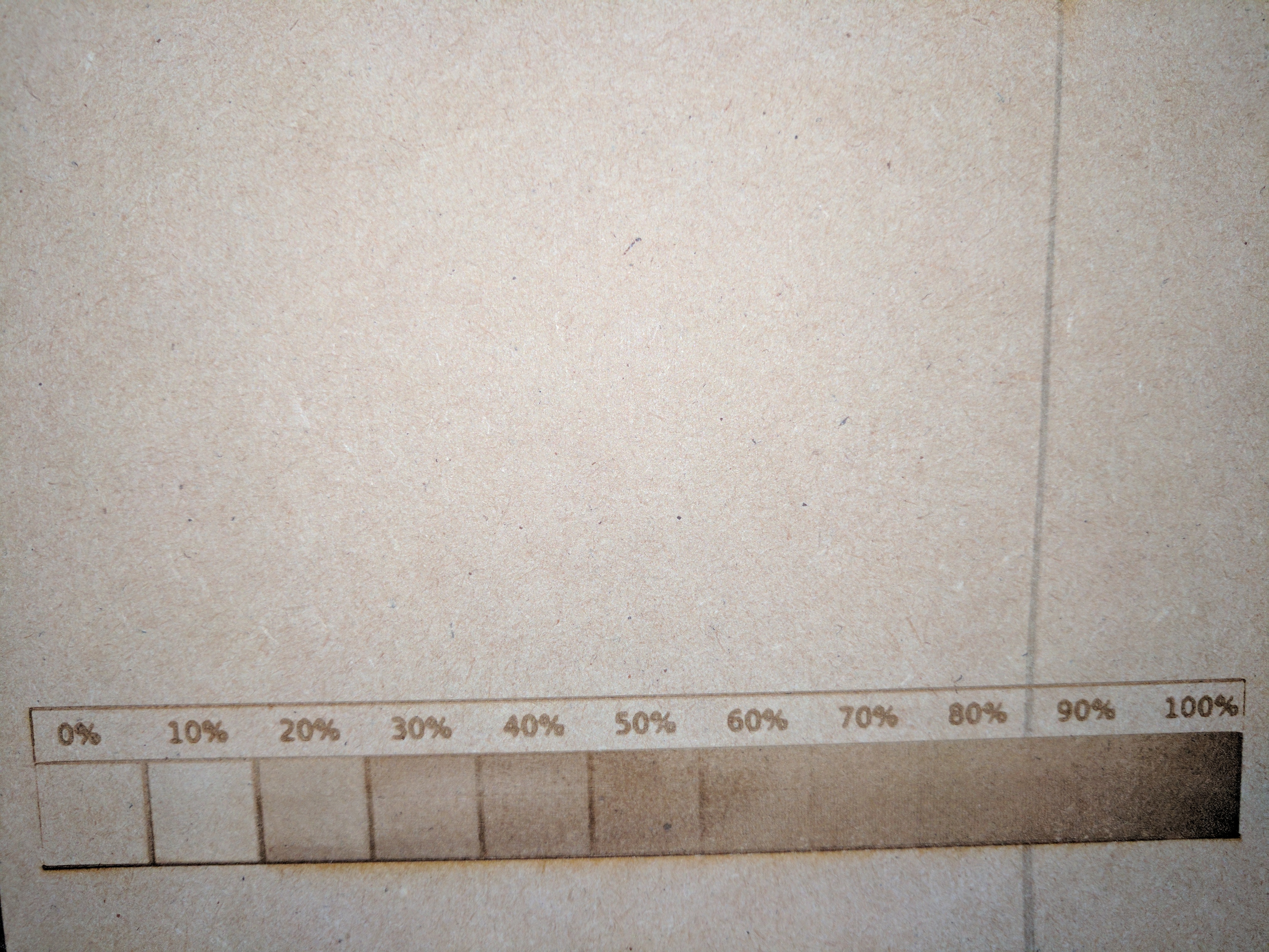

UPDATE: PWM is working!! but cuts have been effected.
@donkjr not sure if the pwm is working correctly. In the test gcode i posted above I set the power level to s 0.2 and the laser runs about 12ma if I set it to s 0.3 it runs at 24ma. when I have the M2 nano board it would cut the 3mm mdf at 12 -13 ma now with the MKS at 24ma it almost makes it way through. @Paul_de_Groot the E2 pin is the laser fire pin the Fan pin is the pwm.

Ok I have pwm working (somewhat) I have changed laser_module_pwm_period from 20 to 200. when it is set to 20 the power option doesn’t really make a difference when it is set to 200 it definitely makes a difference. Using the same speed and ma as when I had the M2 nano board it doesnt cut all the way through 3mm mdf as it did with the old board. Any ideas?
looks promising… Original File

@Ben_Myers it appears your PWM control is working. Try this pattern at different pot settings.
this one (different to first) was done at laser_module_pwm_period - 400 (last one at 100) and 10ma
will keep trying this pattern at different settings

5ma to 7ma 200mm/s 0.1 laser diameter
9ma 200mm/s 0.2 laser diameter
