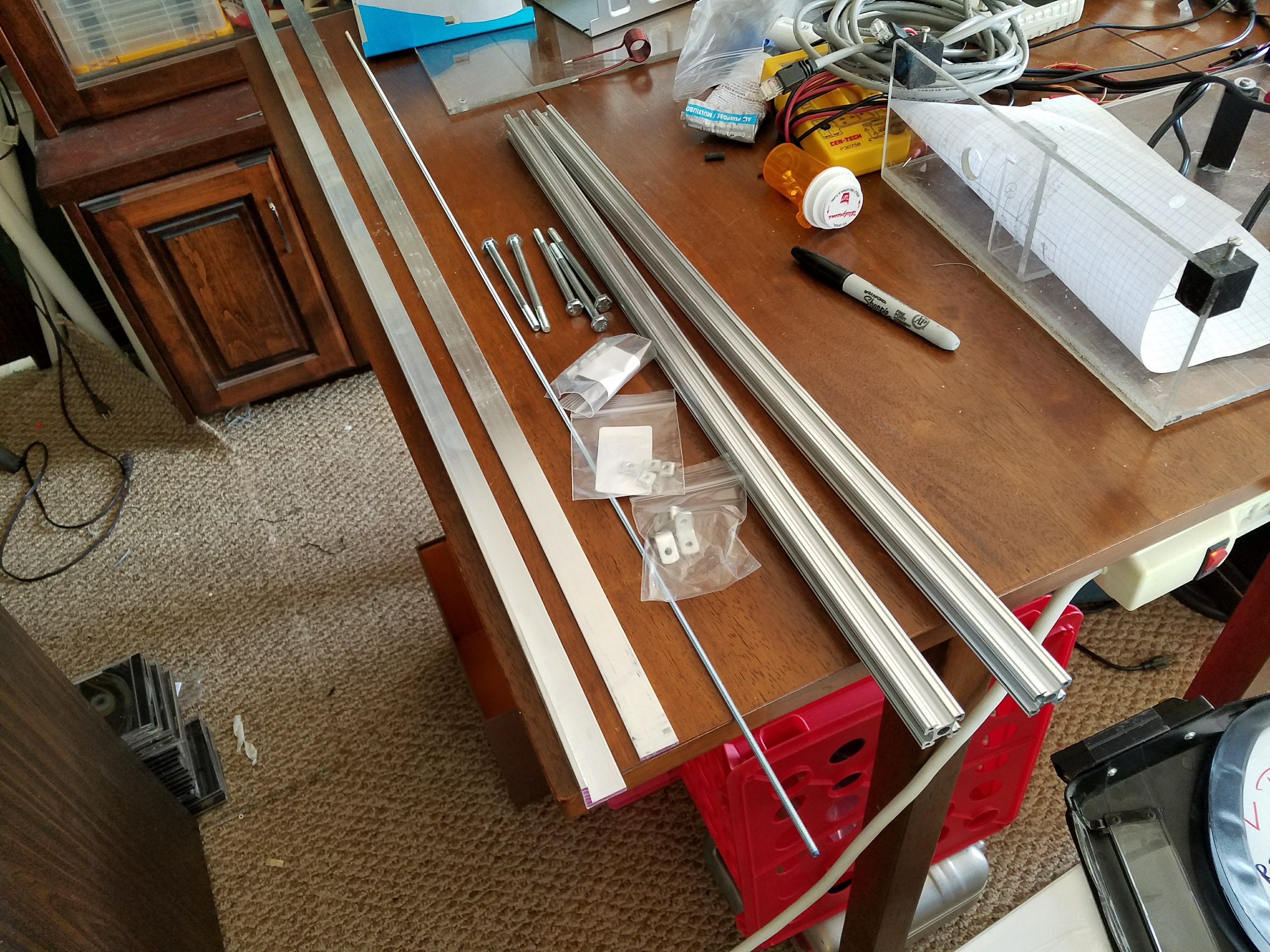

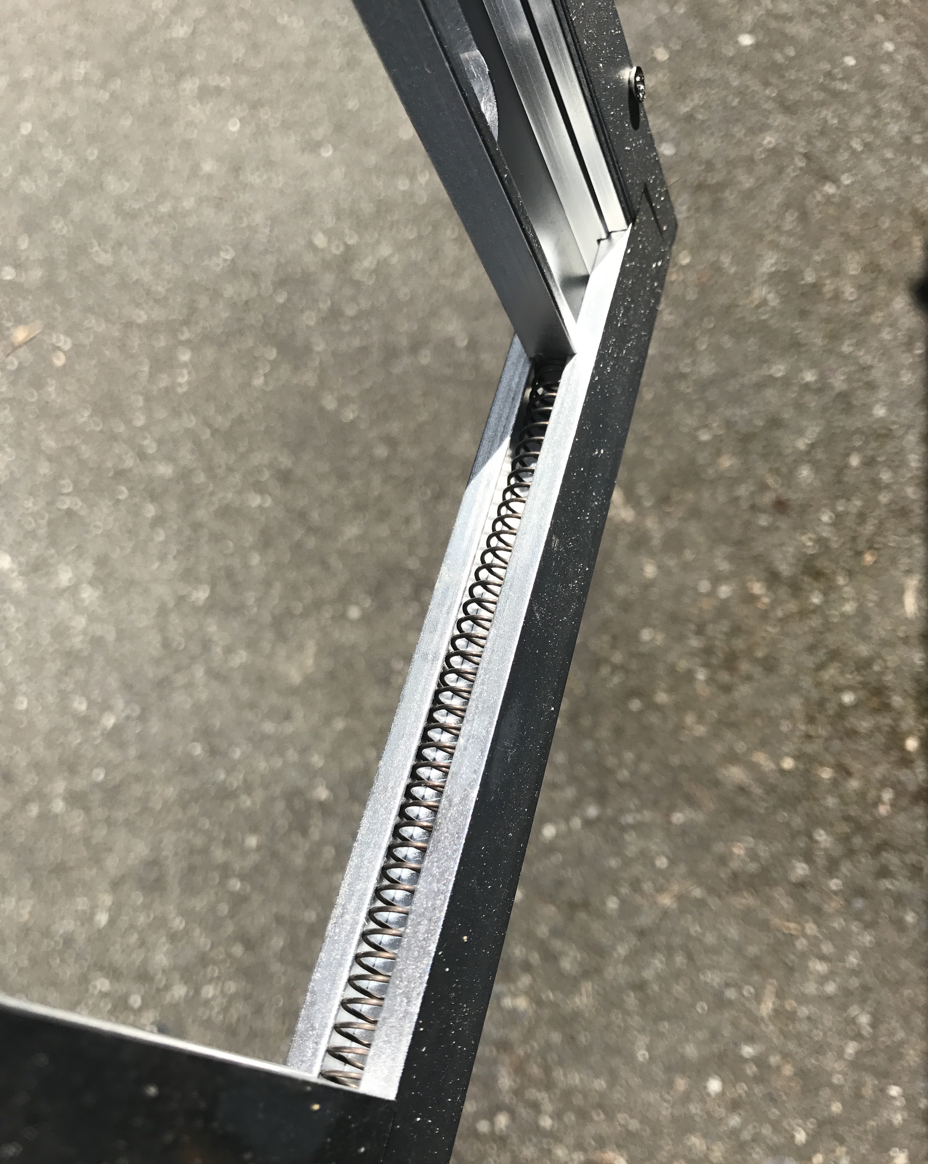

It occurred to me today that the stock K40 stamp engraving bed comes with two long springs that have a wide enough diameter built into the stamp clamp. I’m planning to salvage and reuse them on my forthcoming clamping bed. I will, of course, take lots of build photos and measurements as I go
@Bob_Buechler LOL…
I have been staring at my original clamping table and asking myself “whats so wrong with this approach”. If it was adjustable up and down it would create similar function to what we are doing.
Well it does not hold as large a piece and I don’t have access to those kind of extrusions :).Thats a good enough excuse for me …
Got my parts this week and now it has to wait until after my travels. Wondered what I was going to do about springs, Never did I think about using the friggin springs from the stock bed… thanks.
Saw this video on Openbuild’s G+ community, and thought it relevant to our interests here: https://www.youtube.com/watch?v=cefOJ7PQHjg
Also, I’m midway through my own design’s build and discovered a small design improvement. Good news is, the build can be achieved with off-the-shelf parts, a manual hacksaw, an electric drill (or press), a common vice and typical metric and phillips head screwdrivers. Additionally, the number of modifications are minimal. A couple holes in the aluminum, and cutting the materials to the appropriate lengths, and that’s about it.
I’m painfully slow still in Sketchup, so it’s taking me a long time to get the design drafted. But I’ll post a build log once it’s done and installed.
