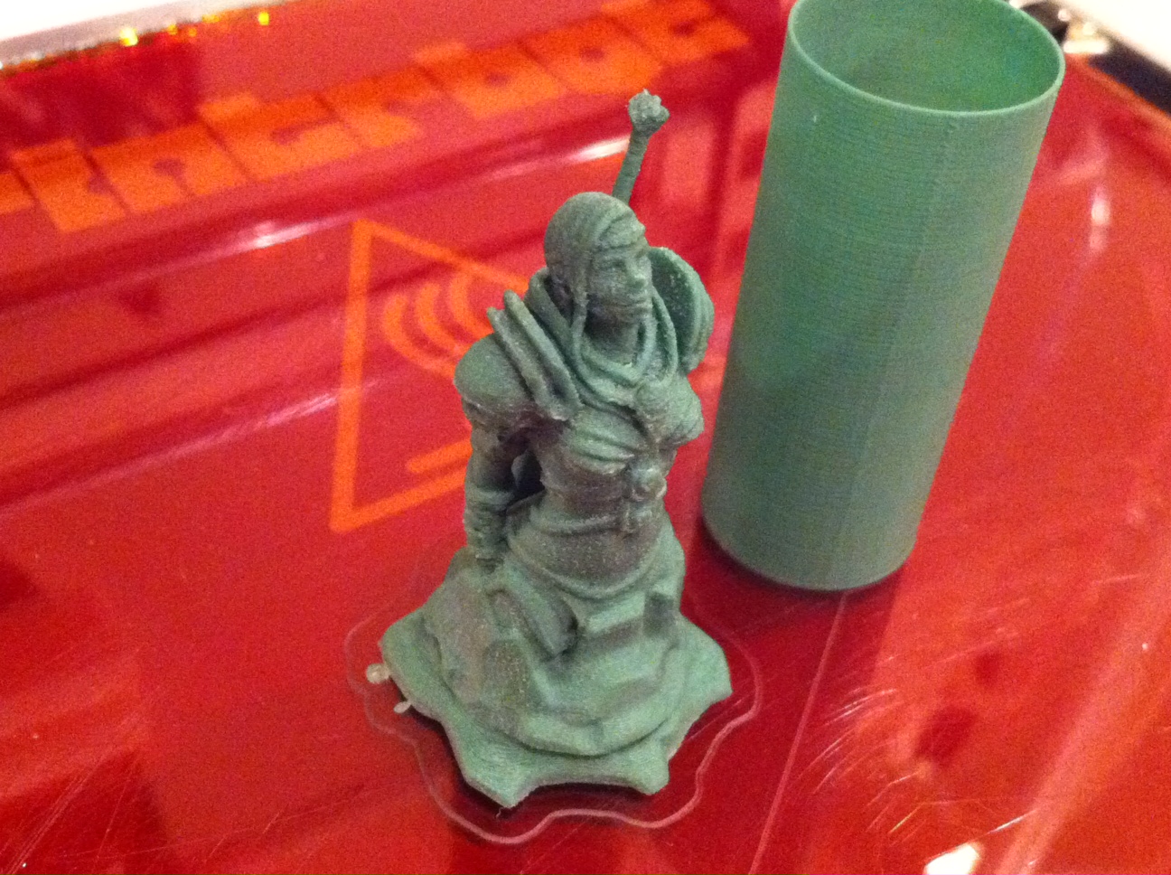

0.20 mm http://www.jerrill.com nozzle on a Printrbot PLUS, 0.10 mm layer height, 50% of STL height for a model height of 50 mm, print time 3:14, using KISSlicer v1.1.0.7 Mar 11 2013. Watch out B9Creator! I’m coming after you! She’ll get an acetone steam bath tomorrow and I’ll post pictures.

Oops… Left her in the acetone vapor bath a little too long. I’ll try again this weekend. https://plus.google.com/u/0/109651299134991445959/posts/bjxXbQDDo1R
