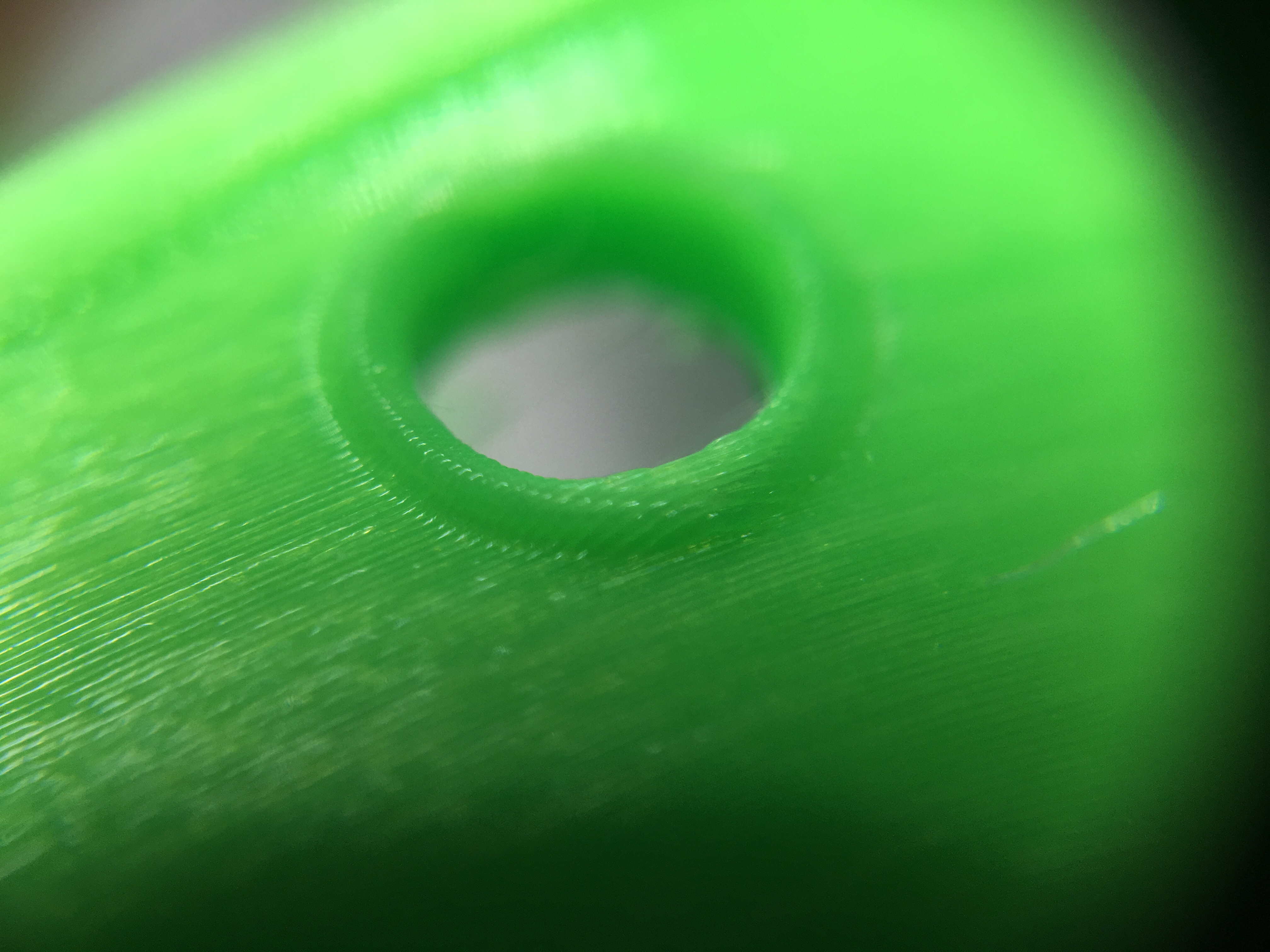

0,2mm Airbrush nozzle is going strong!!! Fullsize benchy and 18mm tall dwarf,
Fullsize benchy and 18mm tall dwarf, both at 0.05mm layer.
Printed on the DICE?
A question about your “services” regarding the DICE: you’ve constructed more than a couple of these printers. Do you contract the CNC cutting aspect for the panels, or do you have your own tooling capability?
I was hoping in these photos to see a comparison of a “typical” Benchy print, although it’s pretty easy to see how precise is your print. The circles are amazing.

@Fred_U yes, that was printed on the DICE.
