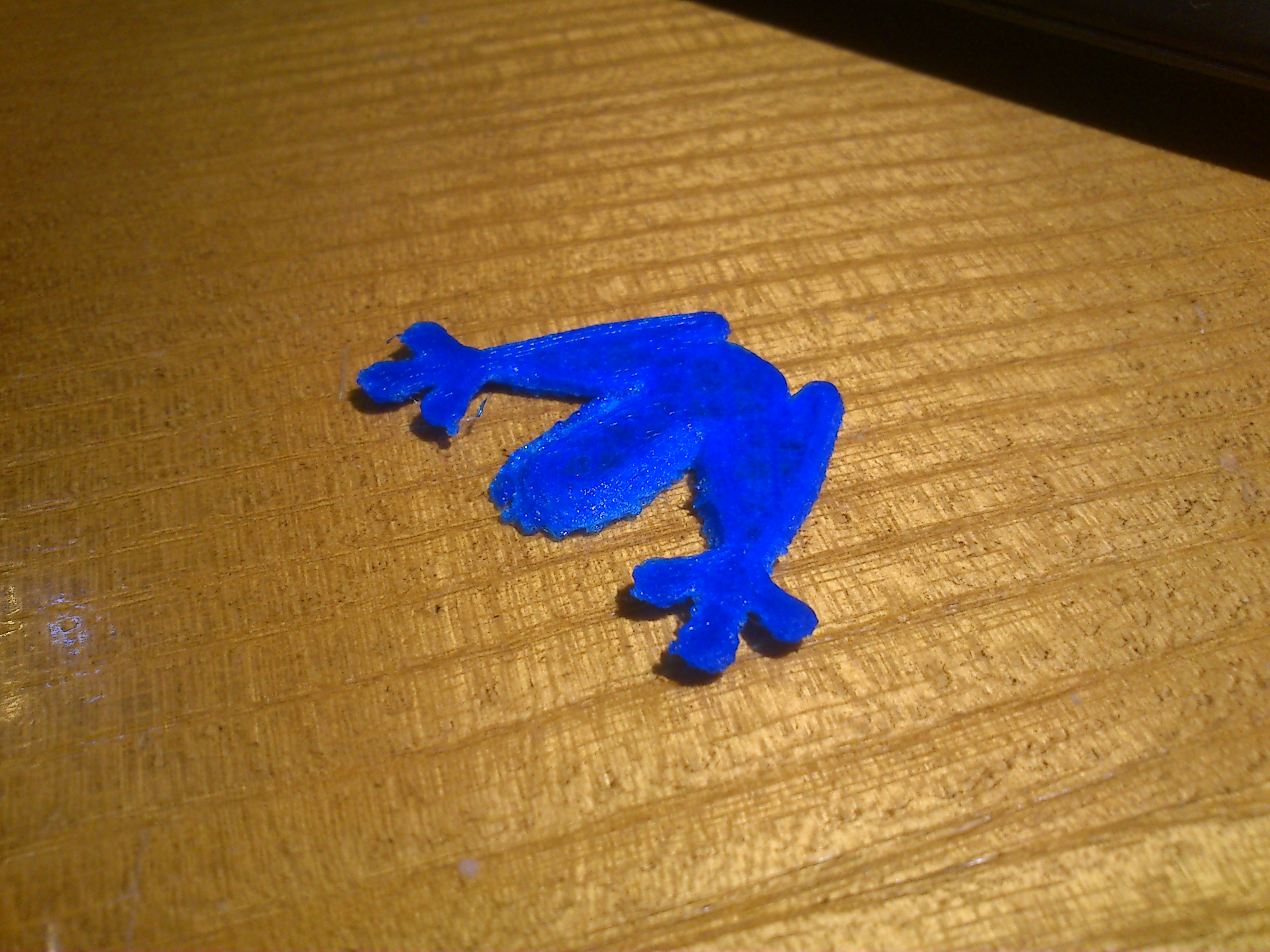

0'025mm layer height tests aborted.
0’025mm layer height tests aborted. I think it works + or -, but my extruder hasn’t got enough resolution for maintain a so small plastic flow constantly. It extrudes spurts each time, they are even visible on the last printed layer.

@Samuel_Ureta all extruders have a minimum reliable volumetric flow rate, there is a chance you are hitting it at that layer height.
If that’s the case, a smaller nozzle may not help.
Your options also include :
-A wider nozzle (thus higher flow rate for same layer height)
-Increase your speed
A higher resolution stepper might help but if the minimum flow rate is limited by friction in the nozzle or some other factor it may not help.

@Tim_Rastall so, if I have understood it right, with a wider nozzle diameter, the same motor movement would lead to a shorter but wider output filament, right? So for doing the same perimeter the motor would make more microsteps and the spurts would be + or - removed, am I right? And maybe the only bad thing about that would be fatter perimeters, a bit less accuracy.

@Samuel_Ureta well, I can try :slight_smile: . As far as I understand it, the viscosity of the molten plastic exhibits a certain resistance to being forced through that tiny nozzle, so at very low extrusion rates, that resistance prevents the extrudiate leaving the nozzle until sufficient pressure is built up behind the molten plastic, at which point extrusion occurs, once the excess pressure is alleviated, the cycle starts again. I think this is something to do with laminar flow but my fluid dynamics learnings were 15 years ago so its probably best not to take my word for it.
