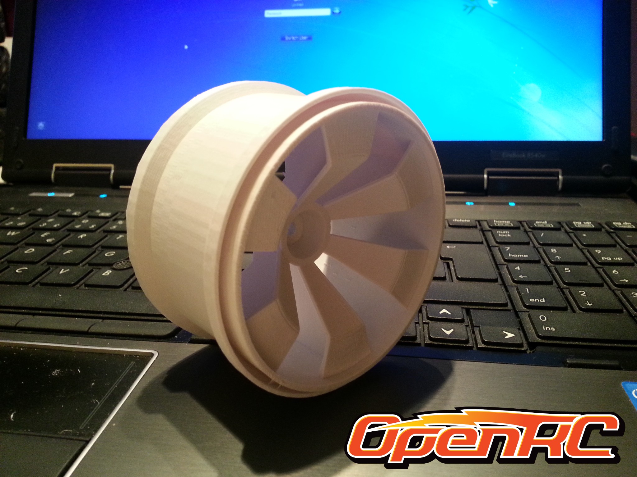

1:10 Truggy Rims
What printer are you using? I’ve ordered a printrbot+ and will be making a 1:10 off-road car.
I’m using a Replicator (1) and a TOM. I have read nothing but good stuff on the Printrbot+… =)
Files available here: http://www.thingiverse.com/thing:39751
How did you print this? Inner part of the wheel facing down + support?
Exactly. If you like i can post a file with support included…
Happy New Year Btw…
I would love a file with support included. Generally custom supports (if you’re using a custom support setup) are much better done than the ones generated by slic3r/skeinforge/etc.
Ok, i will try to post that tomorrow, celebrating new years right now.
I’ve added files with support. It might not be the ultimate design of support though…
